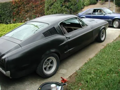

as i said, the front sway bar almost ALWAYS drags on any bump or slight pot hole, and the frame dargs on even small speed bumps......Picture of lowered

65fastback2+2 said:
people always say that, but ive got a shelby drop and 1" drop coils, and the frame drags on small speed bumps, so i would think my car is dropped more than 2" from this combination
From looking at the pictures.. I'd say that your car is dropped at least 2", if not slightly more.
However, the shelby drop does indeed only drop the car about 1/2". I don't know why your car is so low, but I would guess your springs are the culprit... Could they have given you springs for a 6cyln or something?
i dunno, but i love how it sits so im not complaining....all the guys love how it sits, one buddy rode with me last night, he has 12" of overall lift on his FX4 and he goes "wow, im not used to riding on the ground"

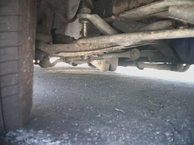

19mustang65 said:
i was looking at my lower control arm to see how level it was to the ground. i also looked at a gt350 last night to see how the arm sat..it was flat. here is a pic of mine
Cripes man, with headers hanging that low I wouldn't lower it that much more. When I had full length headers and stock height it dragged on just about everything. Now I have shorties and nothing drags unless I enter a steep driveway at an angle.
Plus you were asking, so here it is. 620lb spings + shelby drop + 1 full coil cut, although it obviously isn't a 65. You also have to account how your tires may or may not clear when lowered that much.
