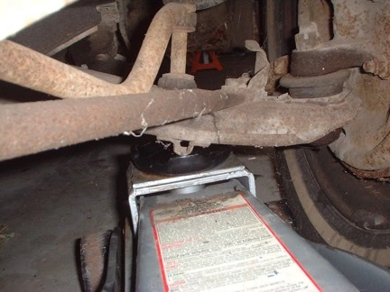

OK, I can't get the jack far enough outboard to clear these two little clips on the bottom of the control arm. What are these clips and is it OK to just jack them up (they'll get crushed, I guess?).
Right now I'm planning to rebuild the front end (Granada spindles) so I gather I'll end up with new control arms, too? Or am I on in totally the wrong area at all?

So it just doesn't seem right to put the jack there. But where?

Nothing wrong with jacking up the car under the lower control arm there, afterall, it DOES support the weight of the car. That stamped steel "U" there isn't going anywhere either. Go for it.
