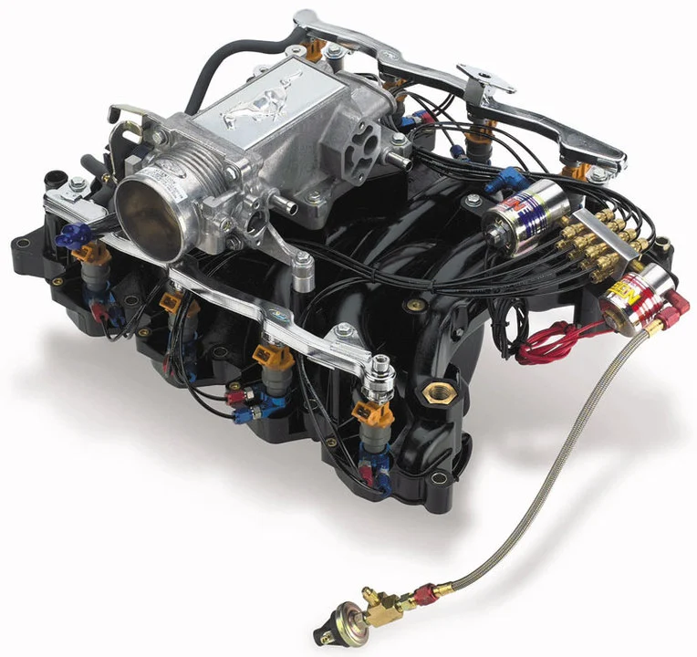

Hey everyone do you know what is the safest size shot I can run with a stock bottom end?
I am looking into getting this kit for my stang.
On sale for 1399.00 from LM Perfromance.

Thats a nice kit, you should be ok with spraying a 125 shot. It sprays both nitrous and fuel under the injectors :nice:
That is actually one of the best designed nitrous kits out for the 4.6L motor.... it assures that every cylinder is getting the exact same amount of nitrous and fuel so you dont take the chance of pushing certain cylinders harder than others, it also includes a fuel pressure safety swtich... so if it sees a drop in fuel pressure it cuts the system off. Big plus, saves engines......
Personally I think you can safely run a 125 shot with that kit if you are running non ethanol 92 or higher gas with some additive and running the right spark plugs and such....
Now if it was a dry kit or a fogger like I have, I dont think you should go much over 100 shot with out taking other things into consideration.
