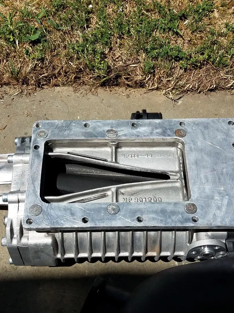

Have an upgraded version available. The early versions used an mp90. I have an mp112 which is larger, but fits on a saleen manifold.

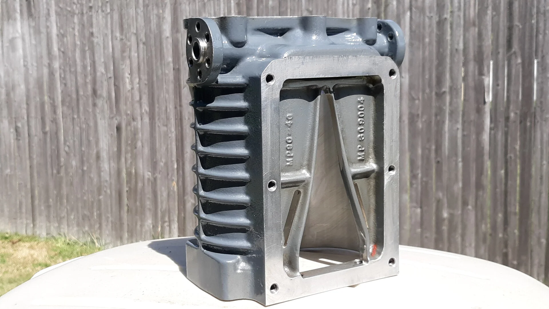

Here's a shot of my own mp90 S/C I removed from my 2002 Saleen. You can see the mp90 stamping. The second pic is my mp112. They are almost identical with the exception of a longer length on the mp112.
