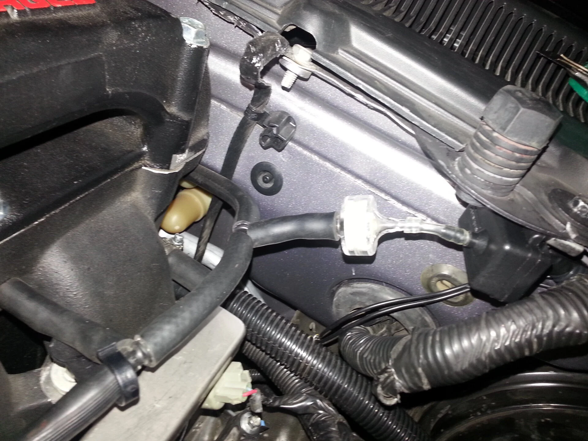

The boost port is on the passenger side font runner. There should be a plug there that you can remove and attach a sender. I think this is after the compression of the SC. On my Prosport boost gauge connection, I attached the sender to the vacuum tube that comes around the back of the SC to the fuel pressure. There is tube port near the back of the driver's side that i tee'd off and attached to. Works for me. 20140113_150246.jpg
Thanks much for the response and picture. Cannot say enough how much I appreciate the assistance. There is such wealth of info out there regarding car performance. I am just in shock of how little help I have received. I usually do my own work on my cars because I don't trust anyone anymore. What I don't know, I just learn on the fly or look on the internet or whatever. This particular topic had me beating my head against a wall for several weeks. I am willing to pay for help but still nothing. Thanks again. I really appreciate it.
