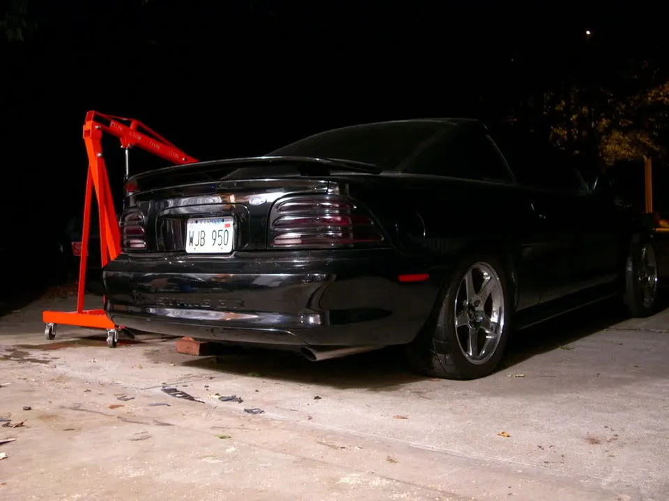

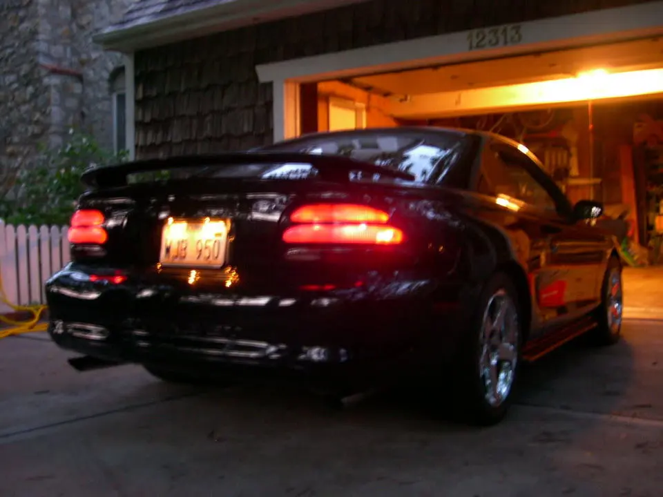

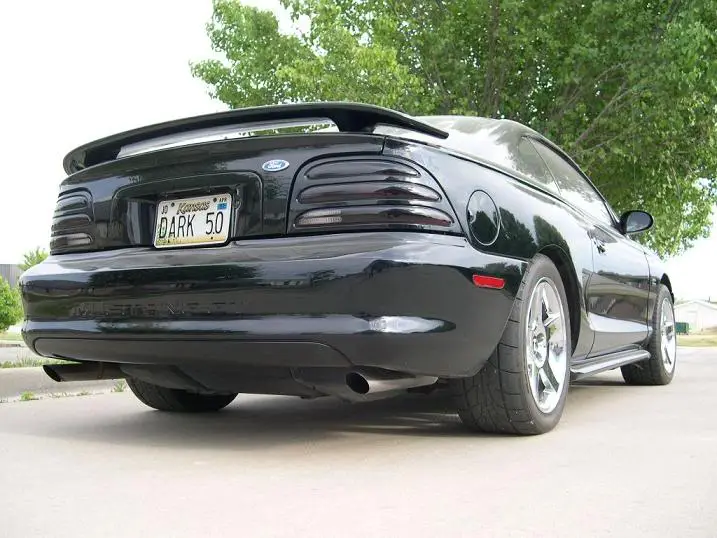

I used vht night shades, its a black transparent paint. I masked off housing so only the red lenses were showing. Then I lightly sanded them with 400. Layed down a light coat, let it dry, light sanding with 800, another light coat, 800 again, then one last coat. The more coats, the darker the lense will be. 3 coats got me almost black. Then I had someone at work spray it with a real clear. So they look factory. But since its transparent, when the lights are on or you have the brakes on. It doesn't look dark at all.

Nik_95Cobra said:
What do you mean? The Saleen covers are thicker both on the outer and inner edges.
perhaps you're right, especially after i take a second look at the pics you posted (i know i've told you before, but your car is one of the meanest on here! :nice: ). i guess i'm just too cheap to go out and buy/look for those covers when i could just paint them myself, heh.
