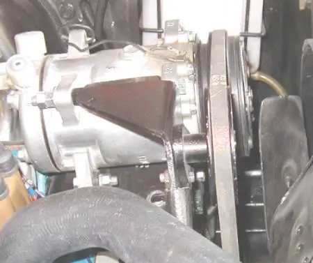

No, I already have that bracket. I need the bracket for my idler arm to be able to adjust the belt. This is the bracket I'm looking for. Scroll down the page and look for Part CAA07183 - Sanden Idler Adapter Kit. Ever heard of these guys?
I made my own. :D Mounts with one bolt.
It has a 1/2in square tube under it to keep from breaking the ears off the compressor.
