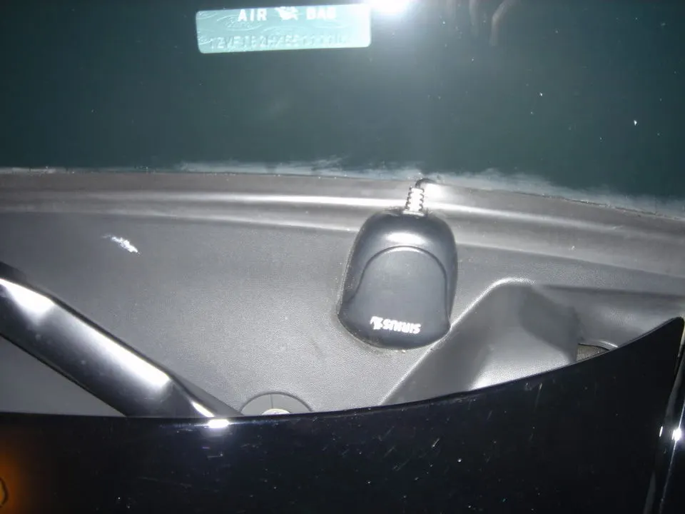

I didn't want mine on anywhere on the Paint on my 06 so I had the shop place it here:
It is right under the windshield. There was no clearance issues with the wipers and the reception was great.
