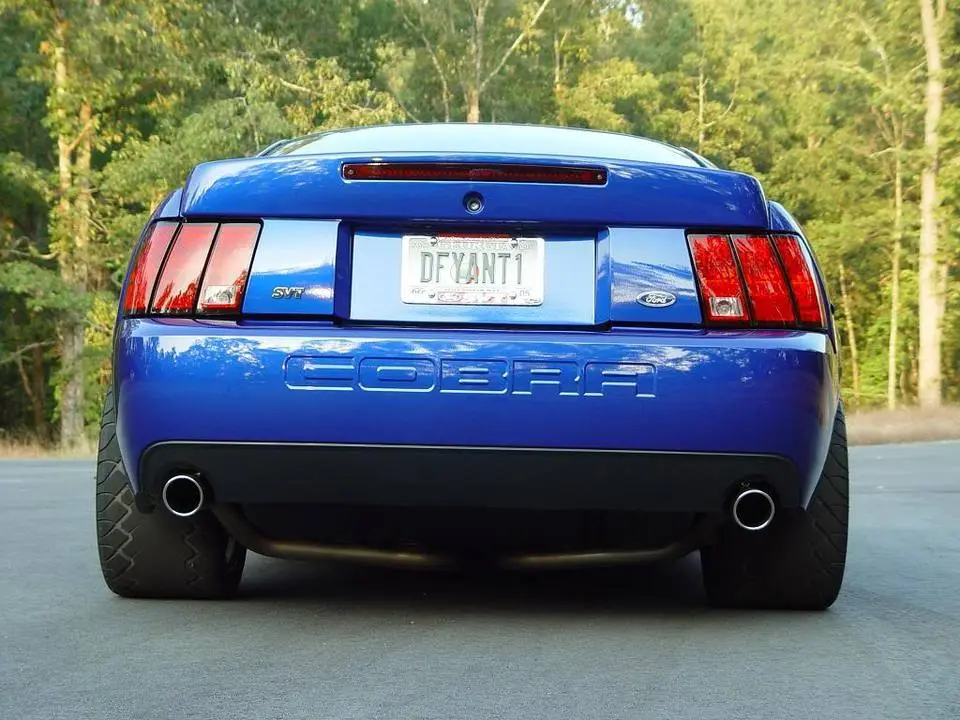

"beefy" as in wide. I saw a 295/35/18 and it didn't look as "beefy" as a 285/40/18 on a Cobra that was in the same parking lot.
Those look like 315's......do you have a 10" wide rim? If so, fitting them won't be a problem but finding one will be. They'll be hella expensive too unless you have a 17" rim (versus an 18" rim).

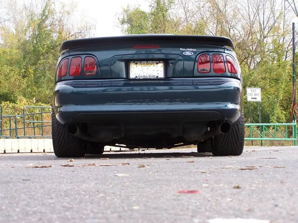

315's look great on Mustangs. I run 285/35/18 Goodyear F1 GSD3's and they are great for street but 315's just look great.
heres my 285's
