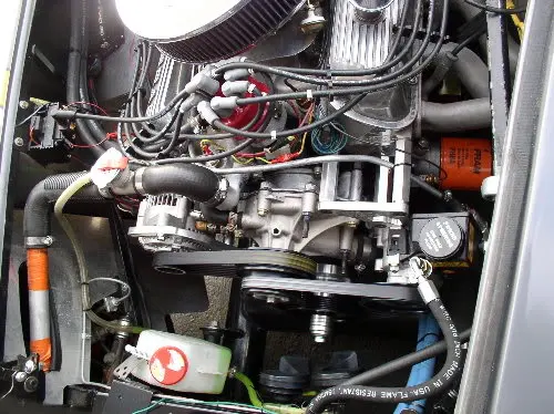

On my FFR Roadster, I am currently running a FMS 5.0 345 HP crate motor with an Edelbrock Performer intake and a 600 CFM DP carb, big ignition, etc. Since it is seeing mostly track duty (road racing), it runs between 3000 to 6000 RPM's.

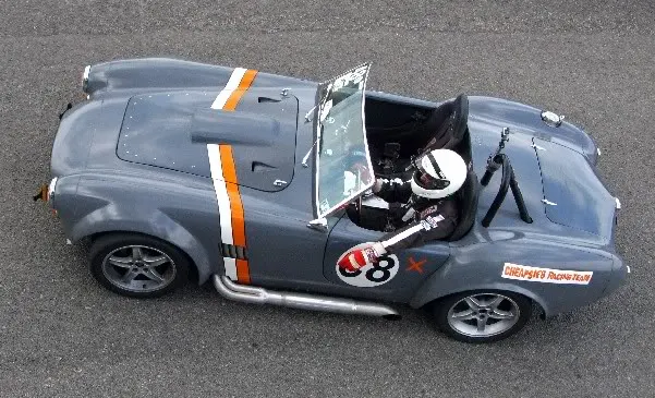

nice car btw, do you know how much it weighs? also, is that one of those kit cars?
edit- just saw the 2190 weight, nice! bet the 350hp feels strong on the small platform
She runs very strong on the track, able to stay with most. Killer in the corners and in braking!

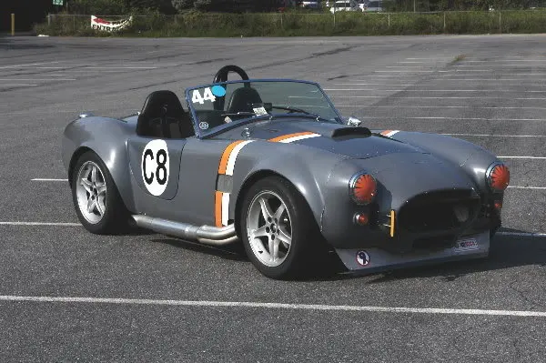

It's a Factory Five MkII I built from 2004 to 2005 with alot of spec racer stuff on it. Still street legal, but more of a club racer now. Definitely not one of them car-show cobras, this one gets pounded. 13,000 hard miles, and one wreck at Watkins Glen.
Top speed so far in 4th is 140 MPH at 6000 RPM on the limiter.
Scary!!!!!
