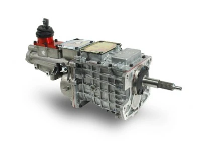

What did the 3550's come in and do they bolt up to a sbf?
The Tremec 3550 is an aftermarket transmission and was never standard equipment on any Ford product. It uses a SROD bell housing from the 4 speed Mustangs.
A Tremec 3550/TKO/TKO 500/TKO 600 is a completely different transmission from a T5. Strong and almost bulletproof unless you run them without proper lubricant or full throttle shift without the clutch.
A Tremec T5 is still the same T5 that is prone to self destruction when used in a street/strip or racing environment
T5, all versions used in 5.0 Mustangs
Tremec 3550/TKO /TKO500/TKO600 AFTERMARKET replacement for T5 - handles racing environments with ease
