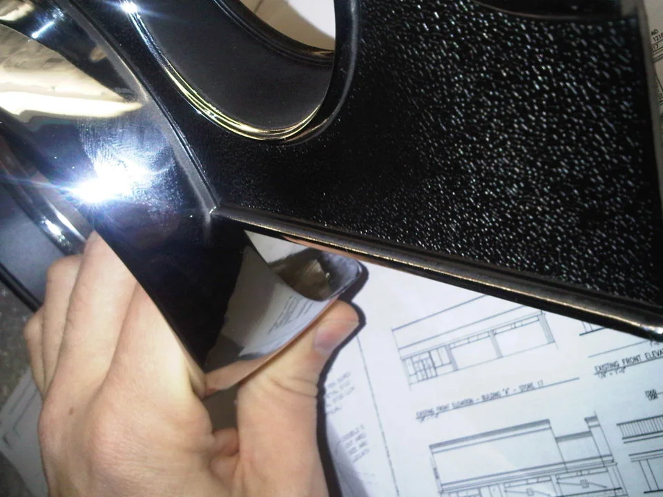

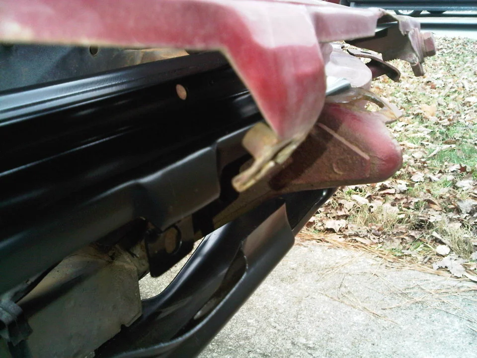

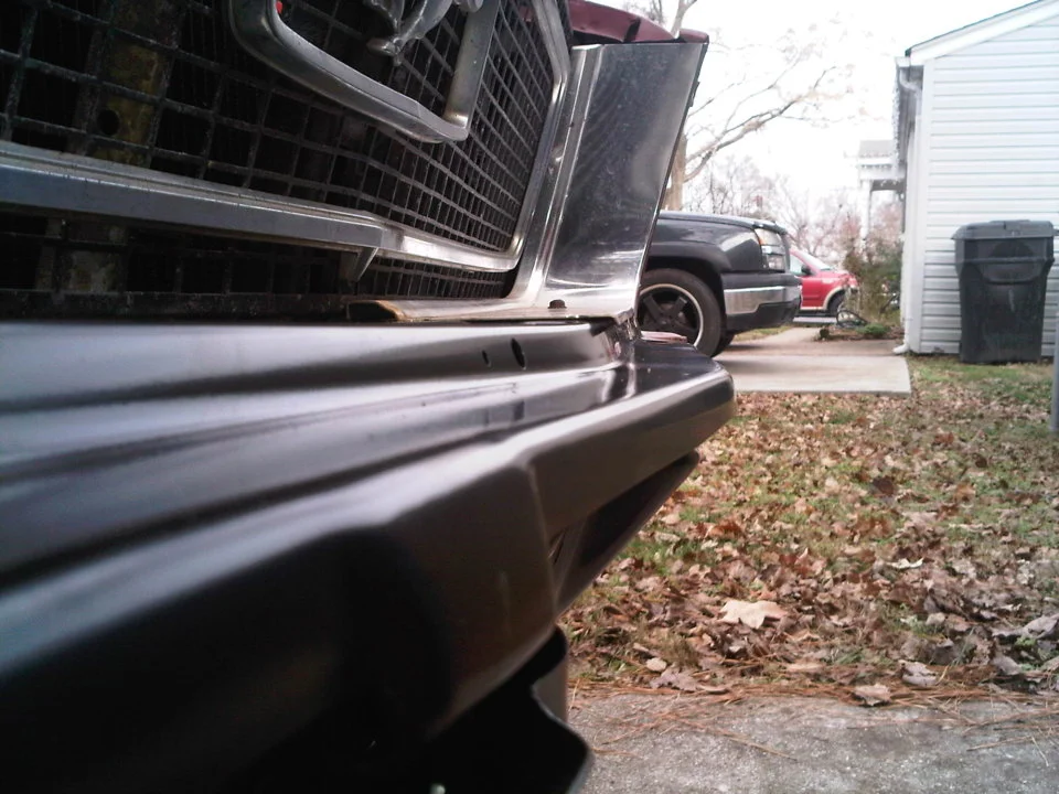

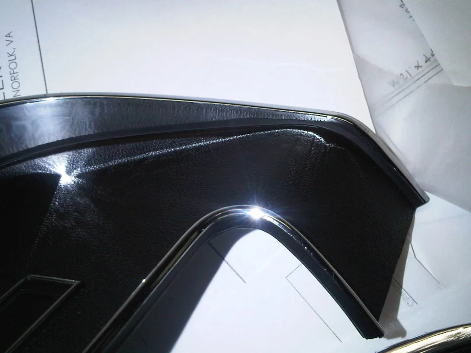

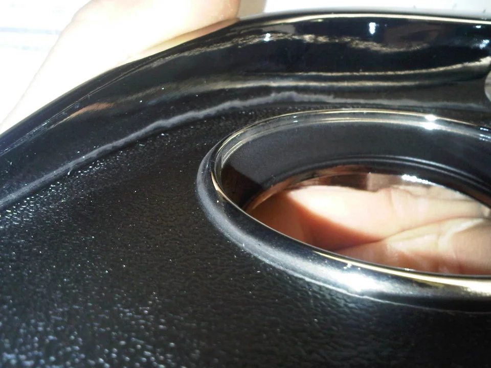

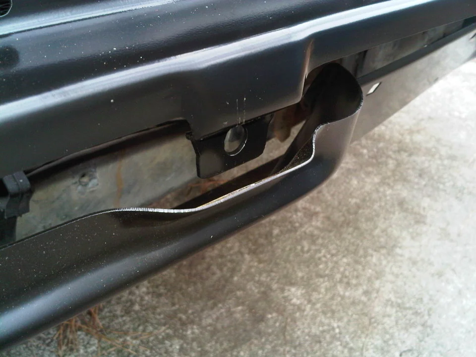

I've been disappointed in just about every catalog part I've bought so far. . .Nothing ever fit right out of the box. . .fine. A little tweaking and filing I guess is expected. But these last parts, one of them wasn't even close (upper stone guard) and the dash bezel (2nd return) was still covered in over spray. I can almost understand the over spray, maybe it was a bad production run that got out. The Stone Guard I was told though, has always been stamped like this. It doesn't even match the original mounting holes on the valence! Not only that, it doesn't stick out far enough to allow me to screw the trim to it. I was lucky enough to get a personal phone call from CJpony parts and they told me they saw nothing wrong with them and to not expect too much.
Really? Am I wrong? Before I go looking for replacements, is this really as good as it will get or did I just get bull:poo:ted off the phone? They did offer me a refund, which I took. Are there better replacements out there?

I'm not sure if they just sent the wrong part. It is part number Dii#3643J, but the front tabs don't look like the correct tabs shown on the picture on their website. On the NPD site, they have an "improved repro deflector" that has a review that reflects the issue I'm having "tab are not correct and poor fit".
If the new valence had a vertical flange where the mounting hole is, there's no issue(aside from fitment). I can't find any literature anywhere stating this, but I wonder if there is an "improved repro valence" floating around I don't know about?

Dynacorn rear quarters for 67 -68 fit quite well but are about 1/8 inch longer than the original ,65-66 are a nice fit ,69s are nice but have a crisper edge along the top of the quarter than the original .Rear valances are all ,make it fit . All front valances need tweaking to fit ,even ford tooling .Ford tooling tail panel and Dynacorn tail panels are very good ,others are junk .Ford tooling hoods and fenders are fair ,the fenders require fitting to the door but are nice other than that .I have never used a Dynacorn hood. Dynacorn fenders are about the same as Ford .Others are thinner metal. I haven't used any of the 67 -68 front valance or stone deflector pieces .Scott Drake floors are very nice and so are Dynacorn .Frame rails ,Dynacorn all the way.
The best pieces you will find are old original Ford parts . Expect to have to massage any new sheet metal some where to make it fit correctly ,but ford tooling and Dynacorn are about the best you can get .

I've heard Dynacorn is about as good as you get, and I'm aware most body panels require tweaking. But this piece is just wrong. Not to be tweaked, but cut and rewelded correctly. To me that is unacceptable to sell as a replacement. But I guess I have to deal with what is available. . .unless I find some good used parts.
Thoughts on the dash bezel? It pissed me off more when I was told "you wont even be able to see it in the car". The thing that really upsets me most about all this, is that no one seems to give a damn. . .
The over spray is pretty bad ,almost like the chrome was not masked . I have a new old stock dash bezel from Ford that i put in my 67 Fastback that i have been saving for years ,the chrome didn't cover in places and black shows through so even the original Ford s were not perfect . I don't know how good the chrome proses is on the new parts ,but you may take acetone on a rag and very carefully wipe the over spray away .Don't get it on the rest of the black or it will take it off as well.
