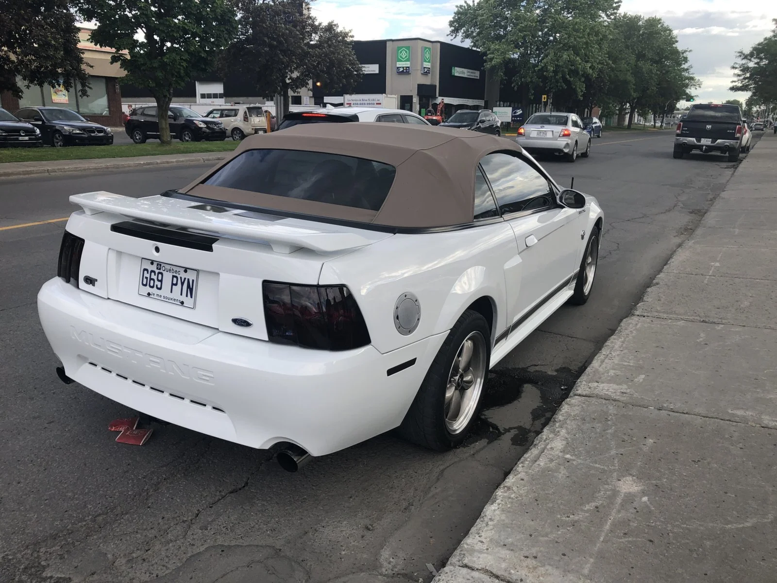

Hi. I have a mustang gt 2004 and I bought the sct x3 and I wanted to know what the parameters are that the custom tune changes on the vehicle? Thank you
