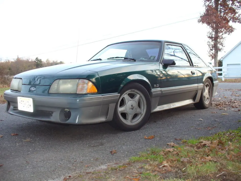

SteedaGT9150 said:
about half a can to a full tank?
your car looks exactly like mine..
