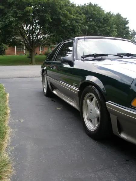

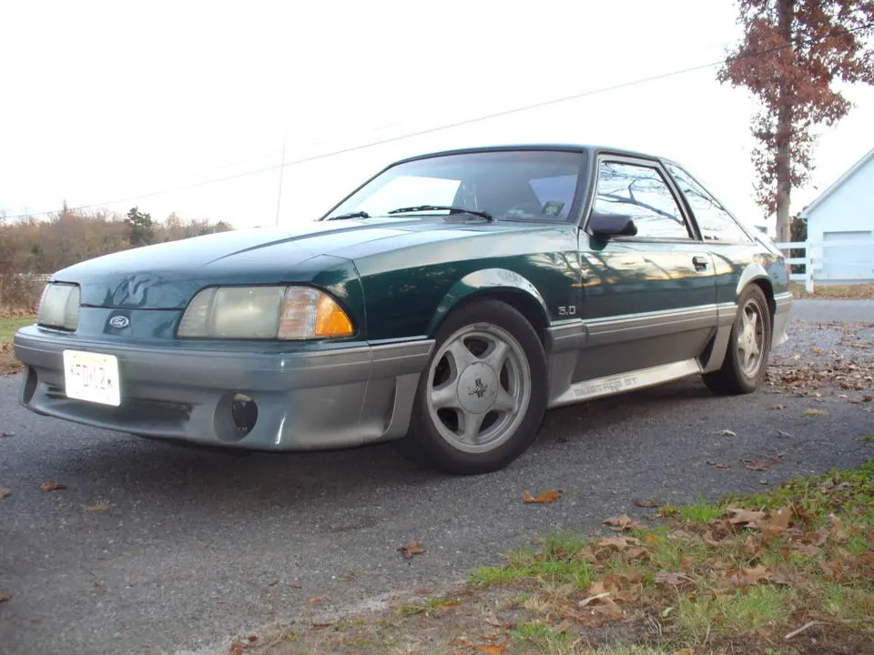

your car looks exactly like mine..
O RLY?
