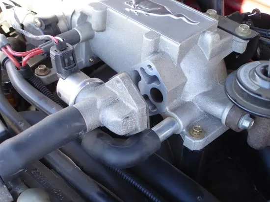

I ran the seafoam through the vacuum hose that goes to the iac valve. Did I trash the IAC valve?
Wait...you mean you fed the SF into the big fat fresh air line leading to the IAC?
If so, this is probably not a good thing. The IAC is intended to regulate the flow of air, not liquid. It may not be sealed well enough to keep the solvent out of the inner workings.
The solvent may vaporize over time on its own. I doubt you'll see much if you take the thing off. Just leave it be for a while and see if the idle improves over time as the solvent has a chance to boil away due to engine heat...
Yes I did. Guess we all make mistakes sometimes. Basically you're saying drive it around for a week or two and see if the idle goes back to normal. Than replace IAC.

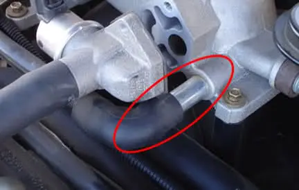

You almost had the correct hose lol. Everyone makes mistakes and you didn't seriously harm the motor/intake. For future reference, this is the valve you want to use for seafoam.....
For future reference, in your picture would I put the seafoam into the hose leading away from from the TB or into the metal port going into the TB?
The metal bit going into the plenum.
The hose runs to the PCV valve which plugs into the valve cover and isn't a source of vacuum.
If I'm not mistaken, on the rear of the plenum is a smaller, more convenient vacuum port used for the HVAC controls. I'd probably use that because (a) it's easier to find a hose to fit it and (b) the smaller diameter will prevent the engine from sucking great quantities of the stuff all at once.
As trinity mentioned, the metal inlet flowing INTO the plenum. An easy way of doing it is to go to a hardware store like Lowes or Home Depot and buy a short piece of their clear plastic tubing that fits snugly onto the metal tube. It makes it MUCH easier to get the seafoam into the motor :nice:
