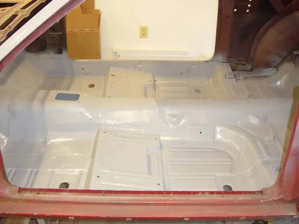

I'm finally at the point in which I can take the 67 on it's maiden voyage out of the garage for a ride down the highway. The only thing I have left is to mount the front seat belts ( lap belt only for now). The previous owner replaced the floor pans, but did not mount the belts. What/where is the correct position to bolt the belts to the floor? A picture would be very helpfull.
Thanks
There's a seat belt bracket that should have been transferred to the new floor. This is a pic of my 69, but yours will be similar.
The seat belt bolt goes in the hole found in the rectangle indentation on the tunnel behind the seat pan. The bracket is welded to the floor/tunnel with a couple of spot welds. The bracket itself is mounted in the tunnel. Hope that helps.
