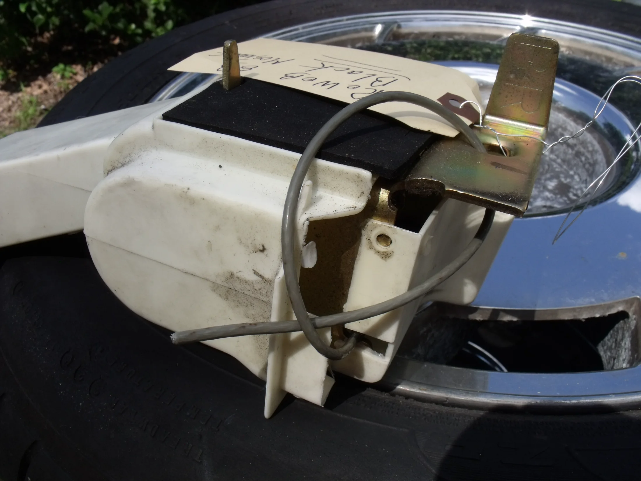

I had to cut the grey wire in the picture to get the seat belt out... Will I need to reconnect it?? I assume its got something to do with a Buzzer...
1983 car....
Ty Everyone
It's actually not electrical. It connects to that button that protrudes out into the door jamb on the pre-1990 cars.
It's a seat belt tension adjuster. Don't ask me how it works.

Glad I asked about these before spending money on them.... The grey " wire " ( thanks 5L5) that I cut, is an actual wire inside a sheath... When the door pushes on the black button it actually pushes the wire ( like a throttle cable) into the seat belt retractor.... So I probably messed this up by cutting it....
I went to LMR's site and the belts they offer will fit a convertible according to there instructions.. .... My " black buttons" all work fine and the cables are good on " one ' side.... LOL.... So if the color was OK I might of reused them.. but the blue interior has left the building....
