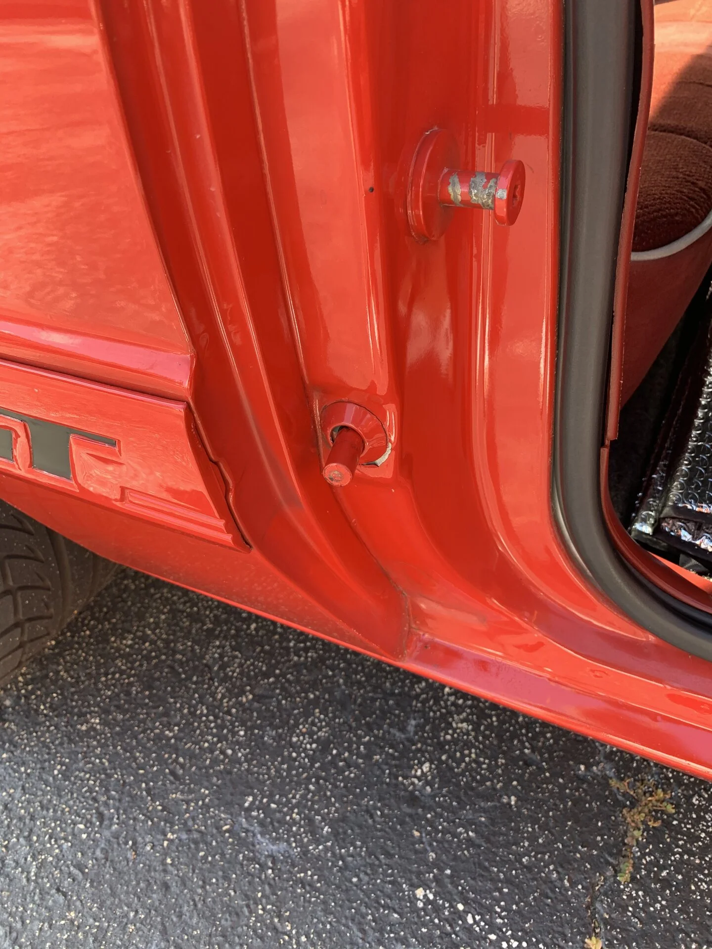

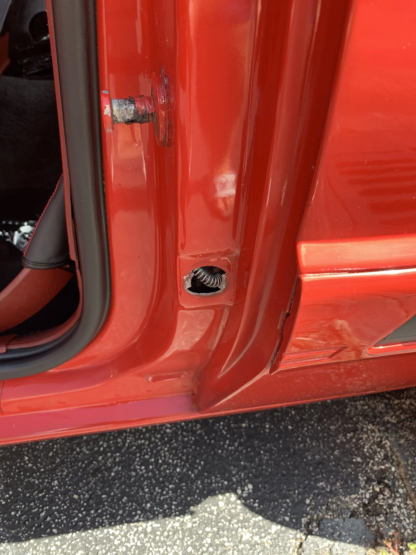

Hi -
New to this forum and posting for the very first time because I was not able to find anywhere how the part on the photo is called and where I may find it. I have posted the photos of the passenger and driver sides. I am missing the driver side. Looks to me this is just a spring keeping the door from rattling perhaps? The spring is still there but the pin and base are missing.
I have a 86 hatchback GT if it matters.
Thanks for your help!

It's a [Seat Belt Tension Adjuster].
There is a plug you can get to plug the hole:
Under normal circumstances, the adjuster is removed when swapping out to a newer set of seat belts with more modern inertia reels.
I have not seen the actual plunger being sold in some time. I just checked again to see if someone has them. I don't see them.
I'd recommend setting the seatbelt to stay fully retracted and installing a clip on the belt itself if you want the adjusting feature.
An alternative might be a junkyard, eBay, or the classifieds section here on Stangnet.
Correct. I am in the process to replace those strikers even if I do not notice any problem with the doors (they are not completely flush with the rest of the body but other than that I have no problem). Thank you for the link.
