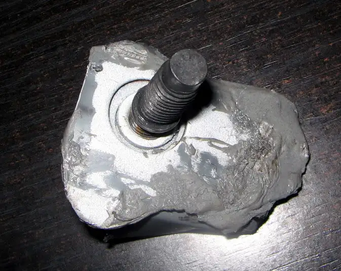

The front right seat stud on the drivers side ripped though and pulled a nice chunk of sheet metal with it... WTF
How am I gunna fix this?
I JB Welded it in place for now, but I doubt thats gunna hold up...

the piece of metal that tore out is about 2" x 1" So Im hoping the JB weld will hold for a while till I get subframes. Then I can run longer bolts.

Im pretty sure I bought the car this way. Guy I bought it from said the guy he bought it from was a big guy.
I dont think im that big... 195lbs
No rust, just tore right out. Metal almost feels like plastic... Cheap...
The subframes that connect to the seat mounts will fix this right?
I thought about cutting that piece out and welding in a piece of square tube... But that would be alot of work...

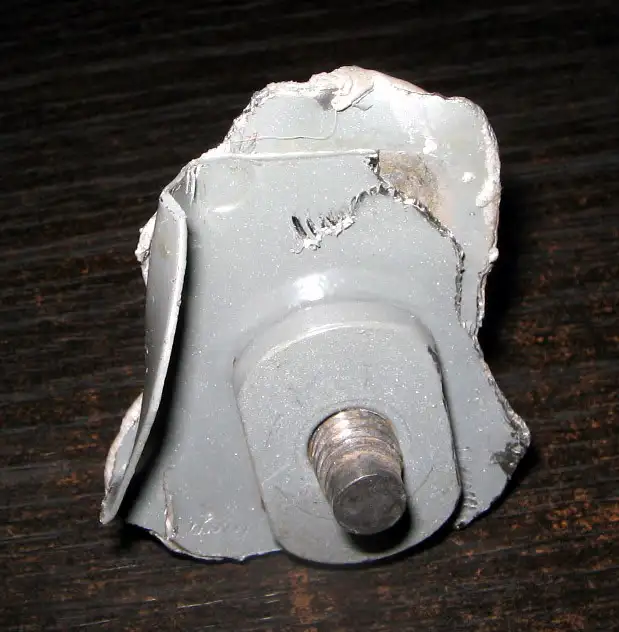

Seems like a longer bolt would be much stronger than rewelding the part that broke. The metal that the front part of the seats bolt too isnt much thicker than aluminum foil...
here is what tore out...
as you can see the JB Weld lasted for about 2 seconds.
