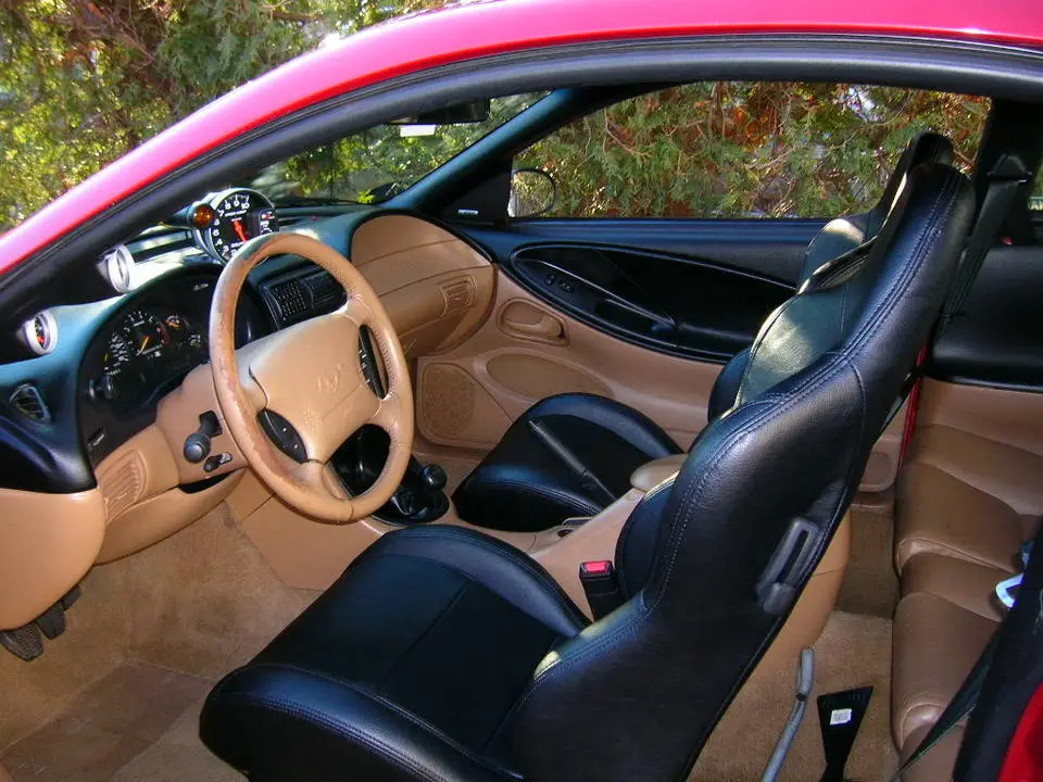

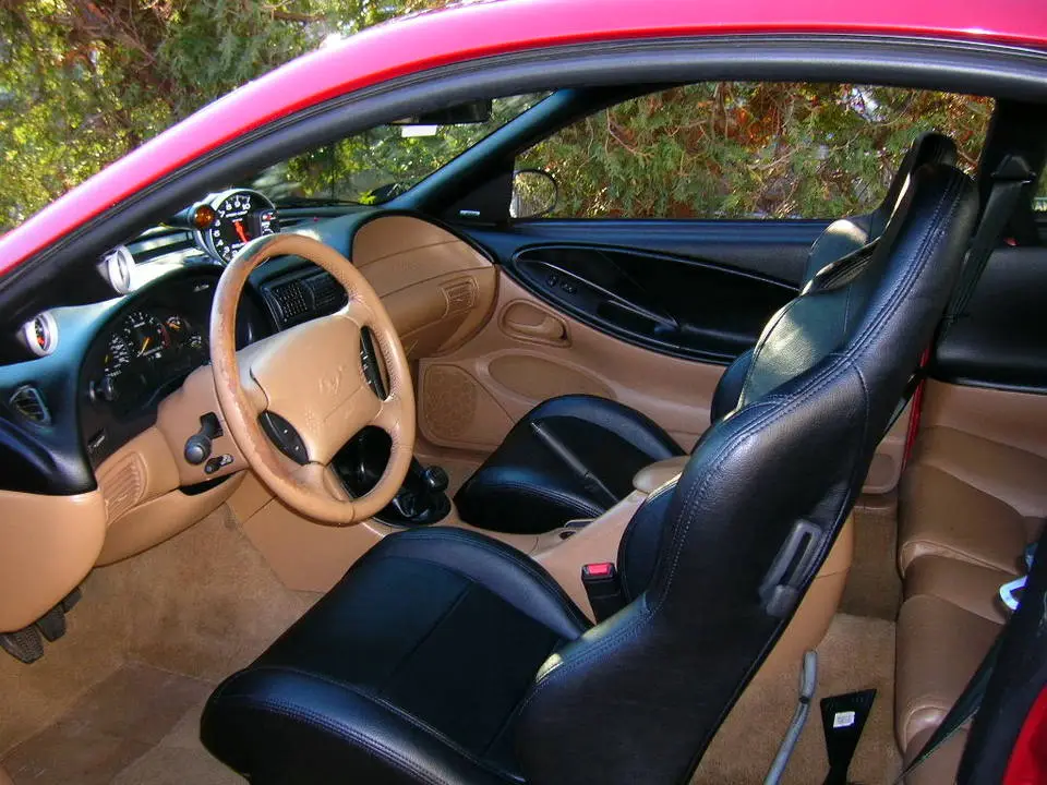

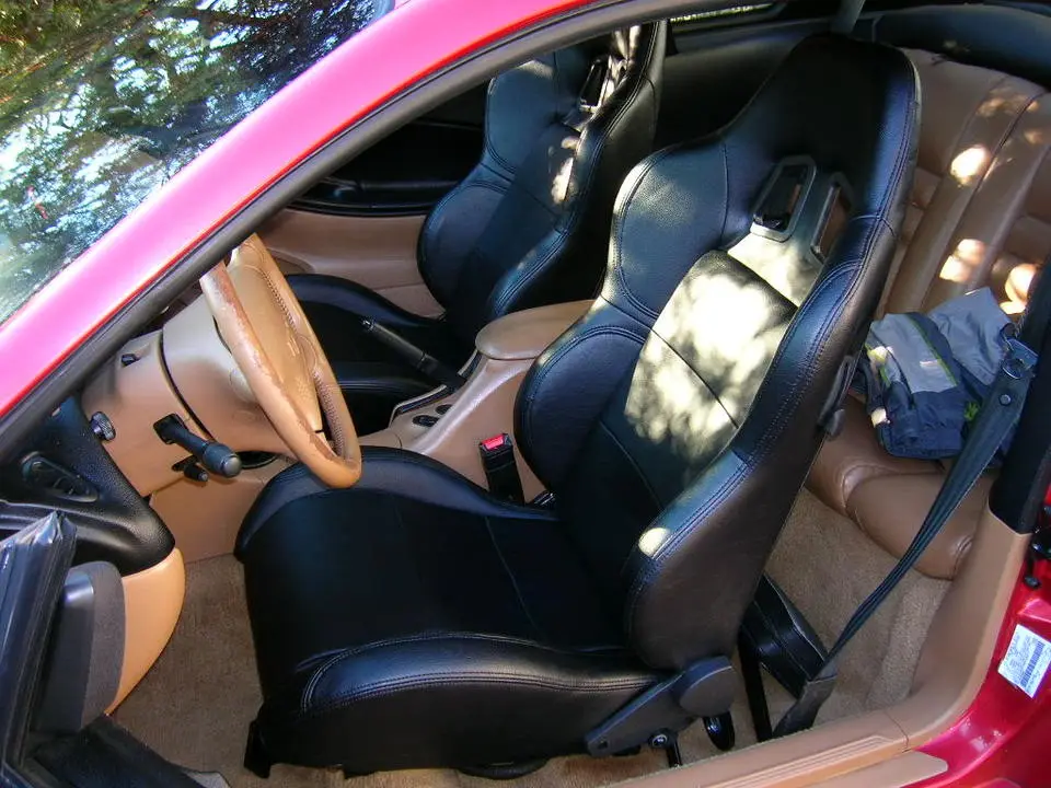

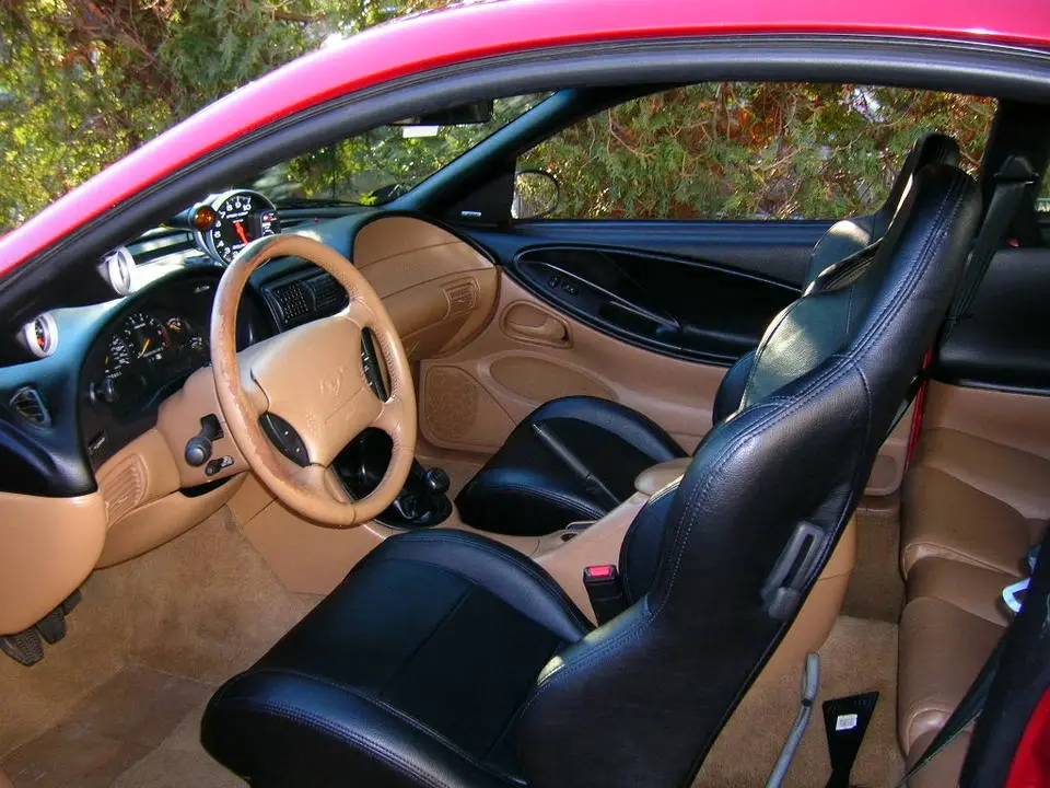

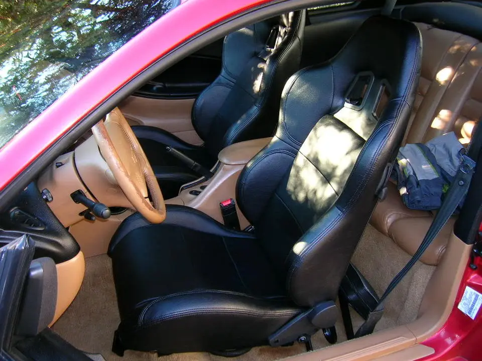

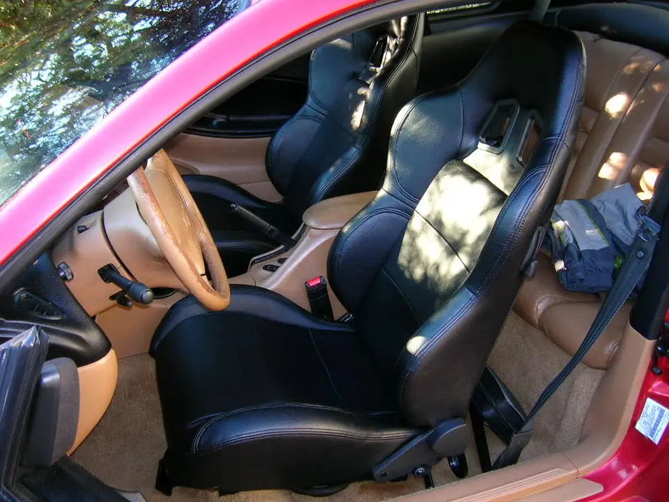

i also hae done this...i re-used the stock sliders with power and just drilled them out according to the holes for the bolts in the bottom of the new seats...that would work well for you since your tall, you can drill them out farther back on the rails to increase leg room...heres a few pics of them installed...

those are REALLY NICE LOOKING SEATS. :eek:
I'm very particular with seats in stangs, but those look comfortable...
most racing seats look awkward to me.
what are those? summits? corbeau?
