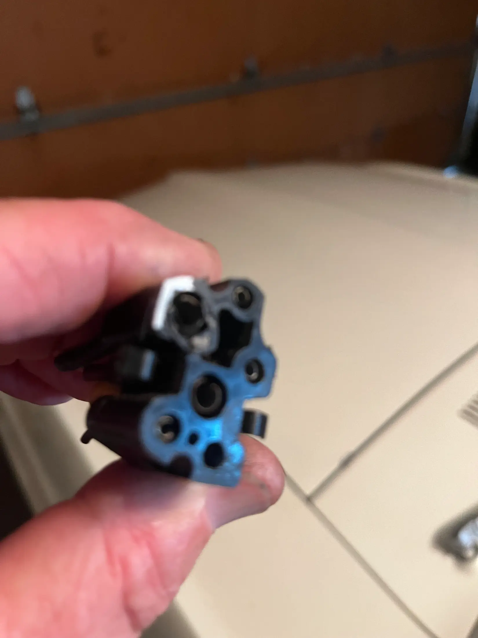

RPM Mach One said:
I had your exact systems a few years ago which turned out to be a bad battery cable from the solenoid. Even though the cable looked pristine upon inspection.
Yes, they go bad on the inside from corrosion... If they are old, replace em....
P
Pony named Pearl
Aug 24, 2024
9
34223
Sep 14, 2024
#22
  • Sep 14, 2024
  • #22
This bad boy appears to have been the problem. I installed a new ignition switch plug and the stang starts hot every time now. Thank you all for your input. I’m sure I will be back. This electrical systems have more wire nuts (slices) than a Home Depot shelf.
