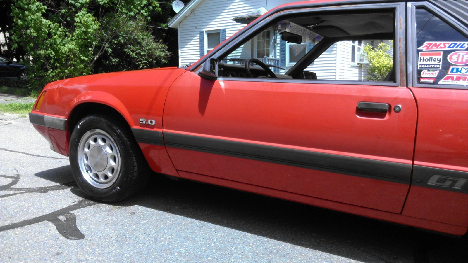

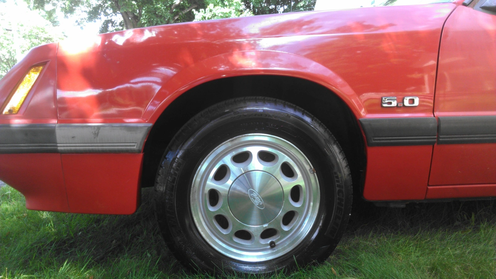

you can see I only worked the front fenders with rubbing compound and then waxed them. I paid 2000 for the car and I have maybe another 1000 in parts in it. Cars from Cali. so it never had any of that damn New England weather to deal with.
