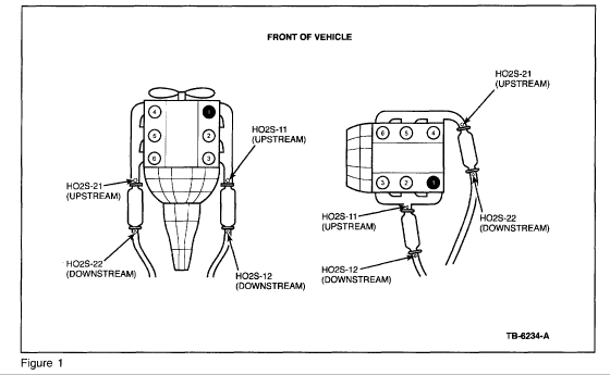

i have a 95 gt,5.0L how many 02 sensors are there parts store says 4 i can only see 2
I just replaced mine a year ago (1995 GT) and it came from the factory with four, two before the cats and two after the cats.

the guy at ato parts says there is upstrem and downstrem i no there is not i have been under the car all day there is only 2 above the cats . any body have a part # they say the up and down have 2 different part # but i know there is only 2 up should i just tell them to get me the umstream and not argue with them are they the same though??

Tell them you want the ones before the cats and make sure they are the same. I dont remeber my part # though.
There are 2 cats and four O2 sensors. Walker still sells the sensors as up and down stream, one left upstream, one left down stream, one right upstream and one right down stream.

There are definitely 4 cats and two O2 sensors. I have my stock H-pipe at my dads if you want me to prove it.
If you really did have 2 cats and 4 sensors then that is definitely not stock.

no there is only 2 upstream that ngk listing says finnaly part#22500 i got them do you guys think i should put them in know or wait till i put my high flow cats on ???if i put them on know will it heart them if my cats are pluged up ??the car is slugges in high RPM the 2 codes are 172 and 176 bolth 02 sensors lean what do you guys think ??
