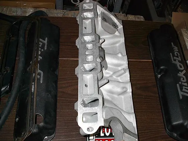

The baffle is inside the lower intake.
As an aside, at some point you'll want to create a sig to put at the bottom of your posts so we can see what components you have in your car. It makes diagnostics easier.
The baffle is just some sheet metal attached to the bottom of the lower intake and usually keeps the mesh pcv screen from falling down into the lifter valley. You can see a pic of one below. What intake do you have on the car?
