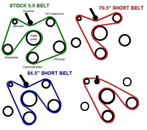

Hell all, new to the forums here. I have 90 foxbody, its a gt(fbo), stock block 302, i've never deleted power steering on it and dont know the belt routing for it, i have everything even a.c just want to know how to route it with everything but power steering, thanks. Also would like to know if you all know the size of the belt i need.

When fitting the belt keep in mind there's enough play in the bracket holes to give you a little wiggle room if you need a little extra length. Just loosen some brackets from the head a little and put the belt on then tighten back down.
