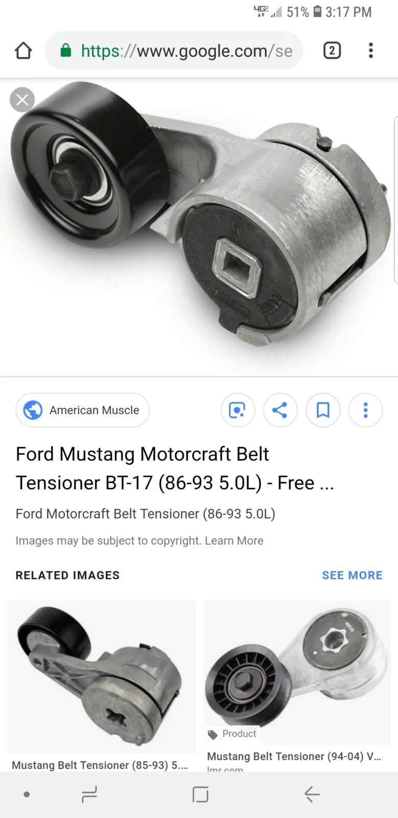

Is your idler pulley smooth...or does it have shoulders like this ?....

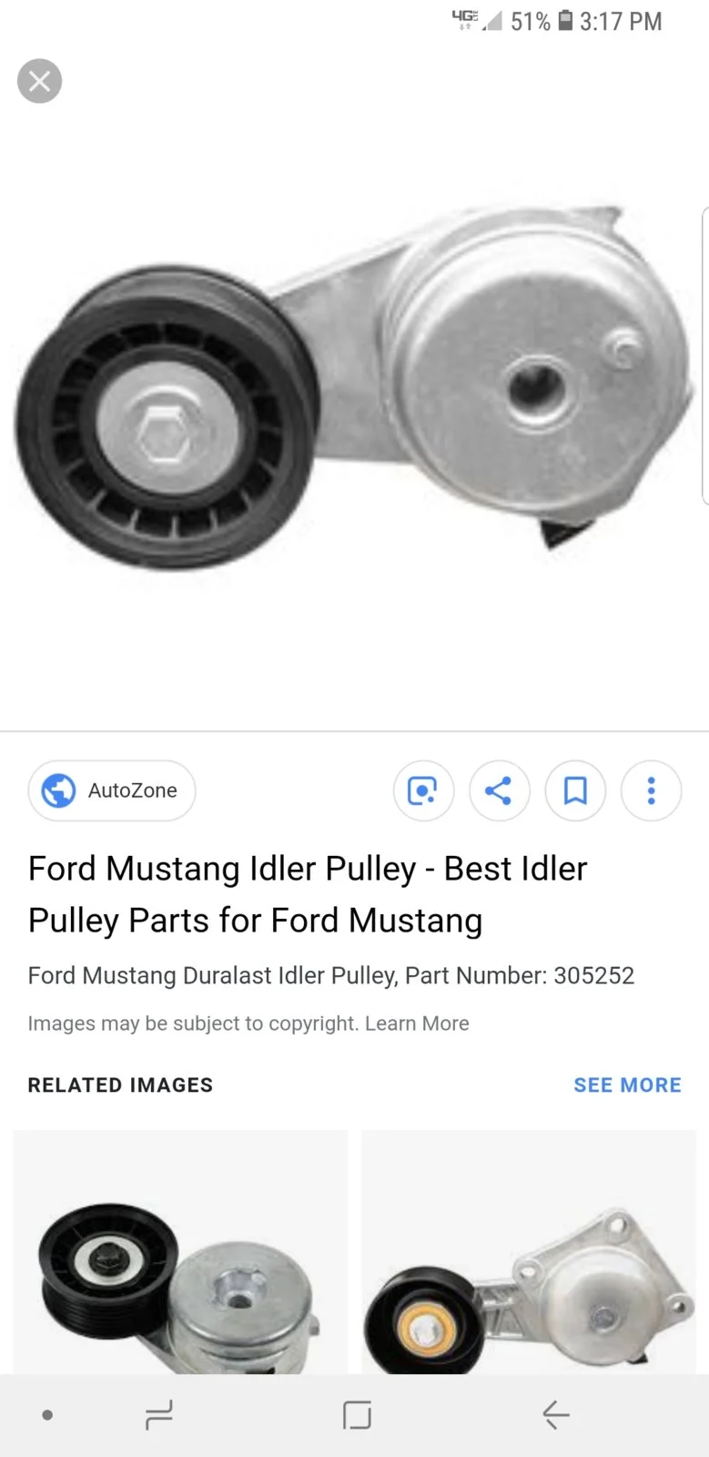

Or smooth like this....
The pulley should have shoulders like the original factory metal one. Under stress the tensioner will flex and cause the belt to throw... or shred.
The only local store that sells the correct one is AZ.... they have been selling people incorrect pulleys for 20 years and won't fix it.

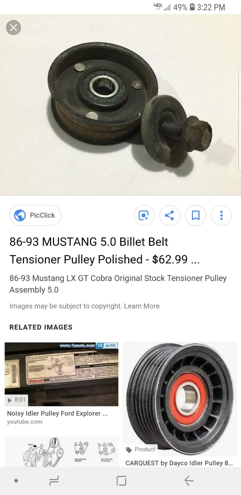

Here's what the original looks like...top pic....
It's also highly likely that you have an alignment issue... but change the tensioner pulley if you have the smooth one also.
