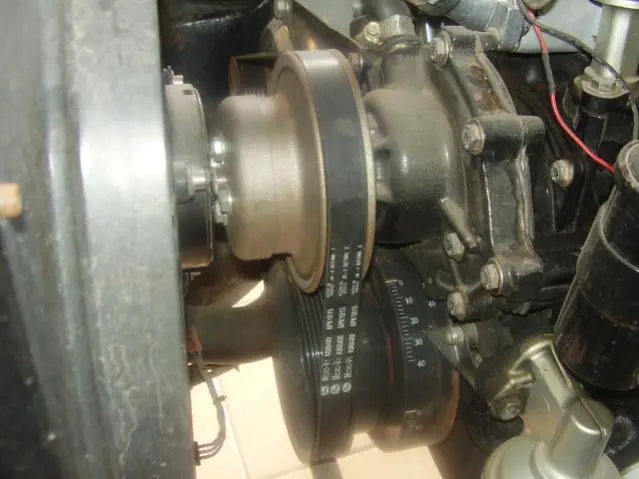

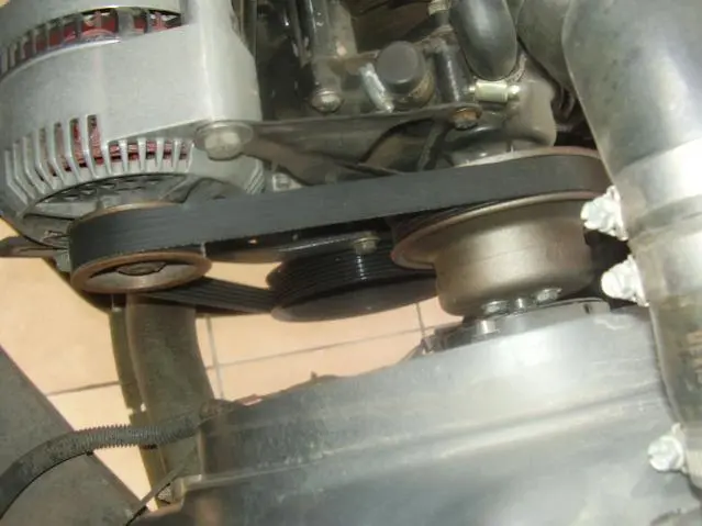

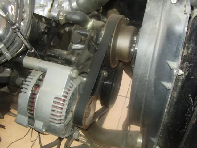

Very dooable
5.0 Alternator pulley
5.0 crank pulley using the spacer provided with my pro products damper
1980's 351w WP pulley
And very inexpensive, only downside is finding the WP pulley.
