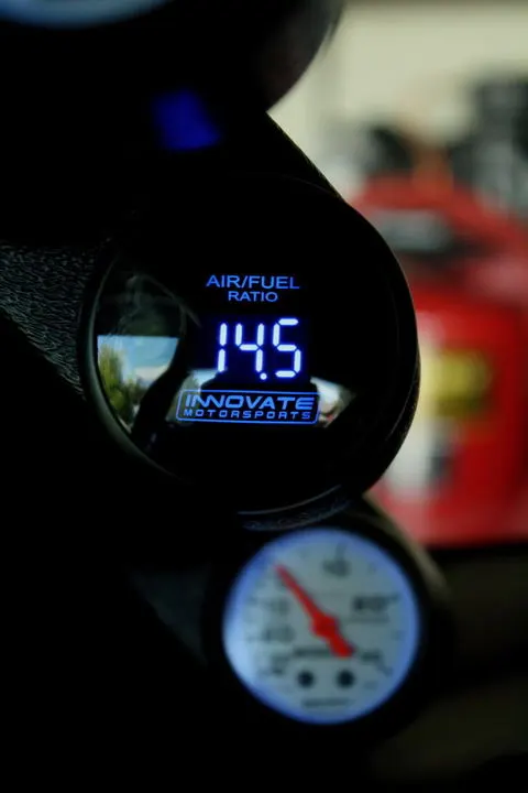

What ignition would be recommended? what Box, Coil, Wires?
What gauges would be recommended? Want to keep it to 4. I was thinking Wideband (innovate), Boost, Fuel pressure, and temp or oil pressure.
How were u going to do a fuel pressure gauge? Mechanical? The electric ones are really expensive...arent they? (havent looked at gauges in a long time)
I would definitely have the wideband, boost, and coolant temp. Oil pressure vs. fuel pressure is a toss up....(price might make the decision for u lol)

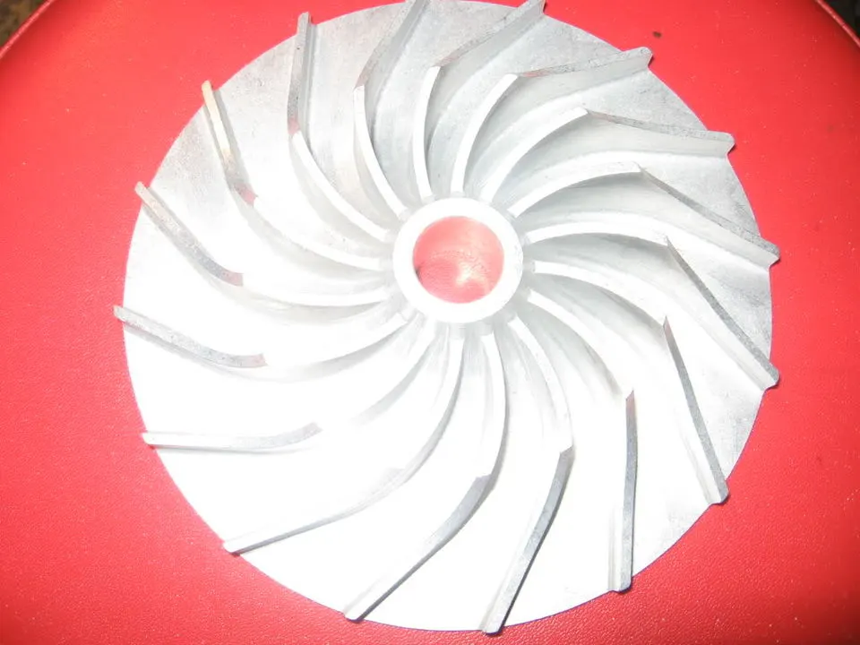

anyone try one of these impellers in their p1?

sounds good, I think Ill go with oil pressure, temp, wideband, and boost.

nmcgrawj said:
I didnt feel the need for a fuel pressure gauge. I didnt want to spend the money for electric...and didnt feel like mounting a gauge on my cowl.
Mechanical = running a tube inside that carries the fluid. I think i read that the fuel pressure ones dont run the fuel all the way inside, but instead us a different fluid? I dunno...you'll have to read up on it. The only mechanical gauge i run is a boost/vacuum.
I did consider running a braided line to my cowl and mounting a gauge outside....i just never did it. With a wideband....you know if you're good or not. And with a wideband + fuel pressure, if something goes wrong, its too late to save it. And if u need to trouble shoot, then u can simply mock something up.
Anyway, in the end, i dont see fuel pressure being absolutely necessary to see from inside while driving....that money can be put elsewhere.
Autometer sells a $100 isolator that you put antifreeze in to use a mechanical fuel pressure gauge inside.. Its a joke... I have one, but will just buy an electric fuel pressure gauge instead..
If you have a wideband, the fuel pressure gauge isn't as critical anymore, but not a bad idea nonetheless..
I have Boost/Vacuum, Innovate Wideband, and Fuel Pressure in my triple pillar pod..
I also bought Electric Oil Pressure and Electric water temp for the instrument cluster bezel, but haven't installed them..

I am going to get the cluster bezel and the clock pod. Not sure what I am gona put where yet. Any recommendations as far as placement goes?
Probably gona put wideband and boost in cluster bezel, and put oil pres. and water temp in clock pod.
Placement is always tricky....they all have their benefits. On the cluster u can see your tach to go with the boost/wideband. But that makes u look down farther, than if u were to just glance to the right and see them in the clock pod (but u lose the quick RPM glance).
