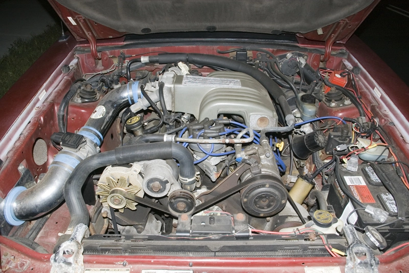

Here are 10 pics, I can take more if you need them. I'm wondering if I have UD pullies, if its the stock alt, if my wiring is bad etc. Also my rad fluid seems low, I see the full hot line but I checked it when I got out and I couldn't see any when I popped the cap but my gauges never showed me overheating. But I'm wondering if that thermostat in the one pic is hooked up right, to me it looks a little junky but I'm no mechanic.

Yeah, that is the idle air control valve:nice:
Your thermostat is actually located going into the lower intake. Just follow your upper radiator hose to the engine, and it goes into the water neck, held on by two bolts. That is where your thermostat is. It doesn't seem to me, that it is an issue.
Doesn't the stock radiator overflow tank have a Full Cold line as well? Try filling it up to there, if it already isn't.
I can't really tell if they are overdrive or underdrive pullies from those pics.
It is real common for the stock alternator not to keep up with the charge that a car needs. Check out www.paperformance.com and get a 3g 130 amp alternator with a premium wire kit. It comes with great instructions on how to change it out.
It looks like you have a Black Magic Fan, I have one, and I hate it:)
Alright, would better pics help or is that something that would be pretty hard to determine

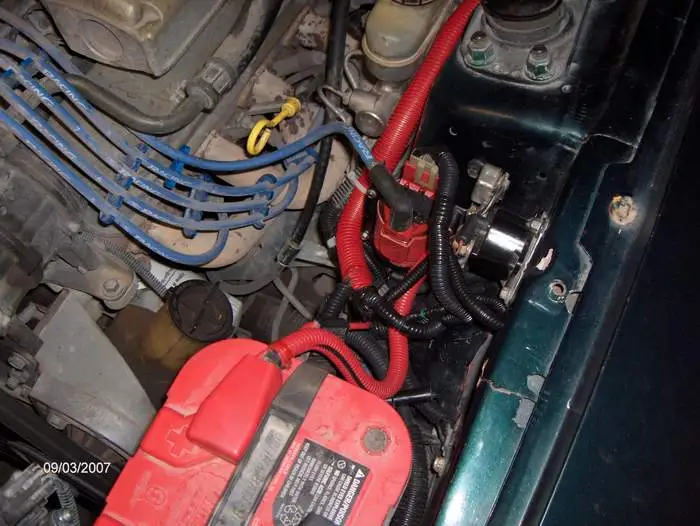

magnj,
Hey there...hope you are getting things sorted out. I must say...we have a LOT in common. I took over my son's 92 hatch and it looks and acts very similar in a lot of respects. I am kicking myself to no end about letting my gorgeous 93 vert get away :bang:
We bought this car cheap for our son, but he left for college and this car wasn't going with him!
I was thinking about your engine dying on you. Have you replaced your fuel filter? It is located underneath the rear...up in front of the fuel tank...round can held in by a clamp near the floor of the car. IF this filter gets clogged, or you have enough gunk in your fuel lines, you can end up with a dying motor just like you describe. What happens is as you drive along the sediment in the tank/and or fuel filter gets stirred up and ends up clogging up the filter outlet. Once you stop and the fuel crud settles, fuel is available and the motor runs...until it cloggs the outlet again.
You might check the filter for this. The worst case is if contaminates have made it past the filter and up to the injectors. The injectors also have a tiny filter and then it becomes a more major problem. Some good gas treatment might be in order too. There's no telling what could be in the gas tank or lines?
Yeah, this GT also came with some kind of electric fan that some 10yr old kid must have wired in. It was awful and one of the first things we yanked. We got a fan shroud, fan clutch, and fan blade from LRS and it has worked great since. The electric fan didn't cool anywhere close to how the stock type fan setup does now.
Good luck...just take your time and enjoy your car.
Ken
PS: I know all about the wiring issues. I spent one whole week cleaning up the engine bay wiring. Traced all the wires, fixed/repaired connectors, covered bare wires....etc.
Laced all new split loom covering for the wire bundles, tied everything up nice and tight and it looks and works a thousand times better. Next comes the interior...ugggg!?! The pix should give you an idea...that's just the coil area! One thing I do is I run all wiring around the shock towers instead of over them...easy to do and looks a lot better. The hood latch cable gets pulled through inside the fender, so it's not visible.
Ken
