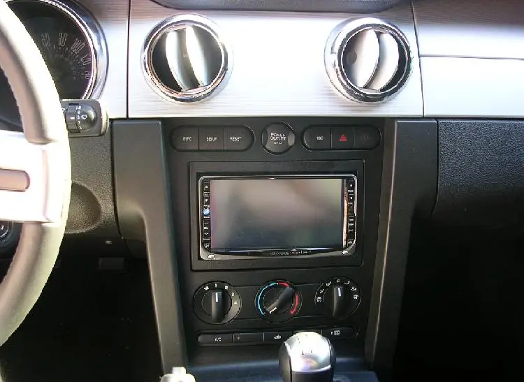

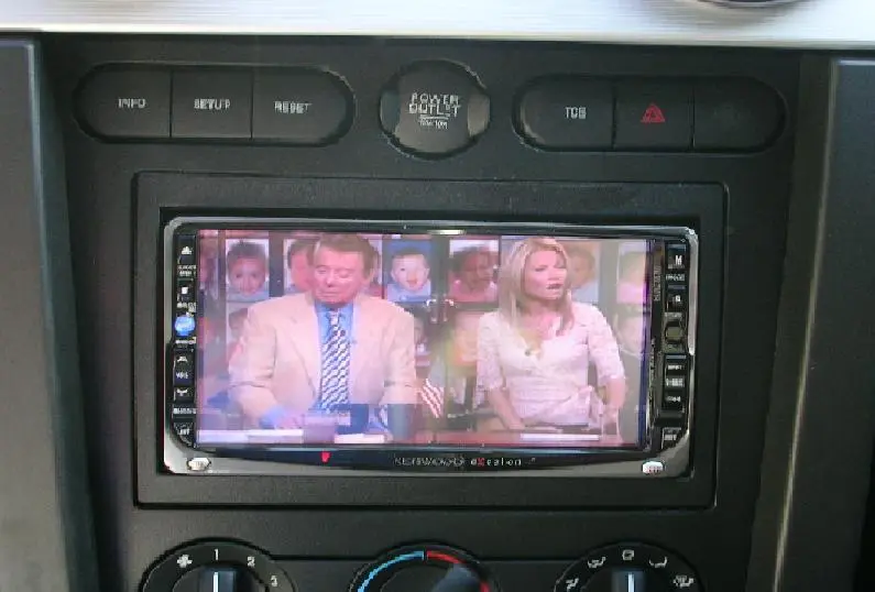

i got the kenwood cd/dvd/mp3 player with tv tuner, here are some pics. it fills that huge hole up great.

Florida Bob said:
Very nice SonicBlueGT05. How much was the unit and were there any installation issues?
Thanks, The head unit is about $1100 without the navigation, $2000 with it. they had to take all of the measurements for the huge hole and they had to build a custom kit for it. as for installation, it was pretty simple, the hard part is making the kit to hold the head unit.
