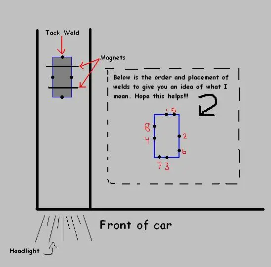

It is really difficult to cover the hole if you have never done it, but if you have a few tips then its a breeze. So here is the best way I have ever seen.
Basically the hardest part would be cutting and shaping the replacement piece.
FIRST You need a good body hammer and dolly for shaping the "plug" piece. Simply try to get the contour of the plug to be the same as the hood line. With such a small replacement piece this does not matter to terribly much. Second After you shape and cut your "plug" to fit the hole with hold it in the hole with a long magnet (having the magnet reach from one side of the plug to the other) and put a light tack weld on all four sides. Then make tack weld after tack weld in a clockwise (or counterclockwise) direction each time spacing them way apart. Basically if you kept putting welds side-by-side one after the next the metal in that area would get to hot and warp. So just keep putting one weld 1-2 inches away from the last until you fill in all the gap btwn the replacement piece and the cars body. Finally Grind down smooth all of the welds, you can do this with an angle grinder. If all the metal is smooth then sand the whole area down with sand paper and then you may prime and paint.

I decided to draw a picture of what I mean, hope this clarify's things!!
