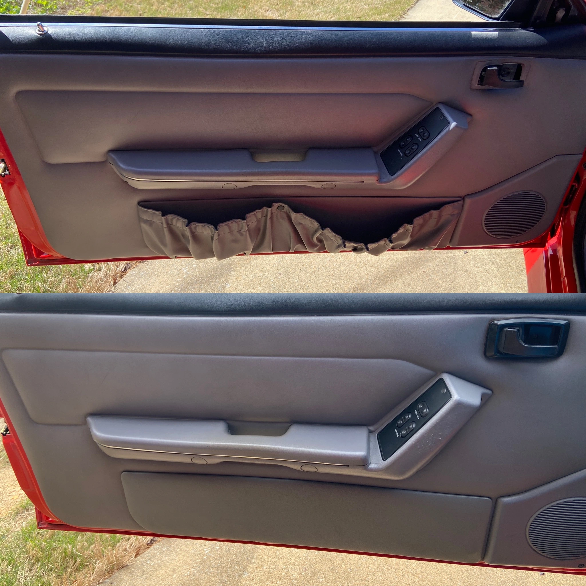

Had some down time so decided to start “fixing” her up(not really fixing) she’s in great shape for a 30yo car. #2341 1993 Cobra. Did the map pocket delete. Hated those damn things and new hatch lift shocks. Got a bunch of small thing’s coming . New coil cover and decals, hood prop holder and a few small interior pieces. I will be changing out the center console to the one with cup holders from LMR. Needs a new headliner but it’s difficult to find a opal gray vinyl one. I’m probably going to have to get a the titanium one. At least most of the interior is simple to find just like all mustangs.

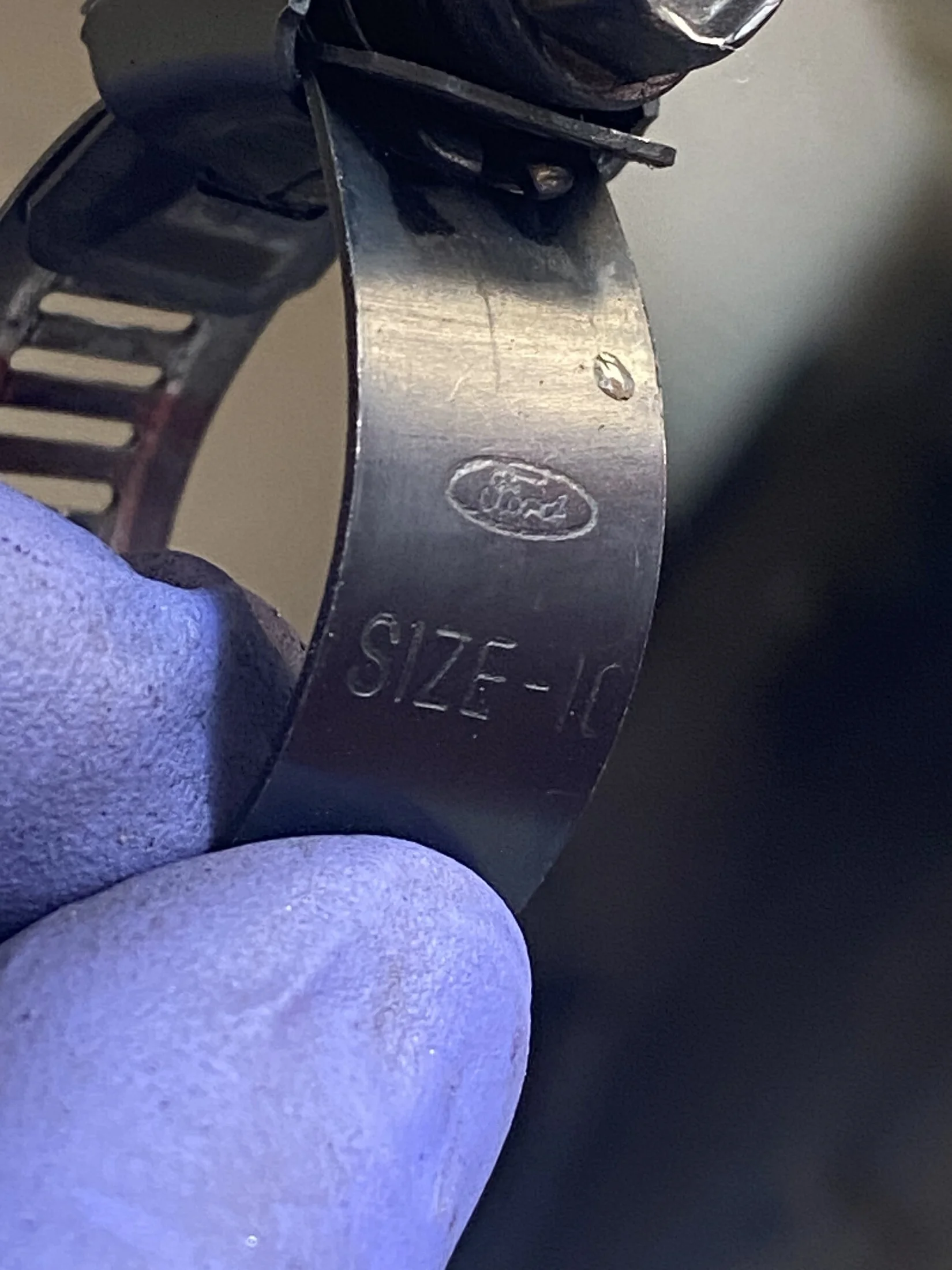

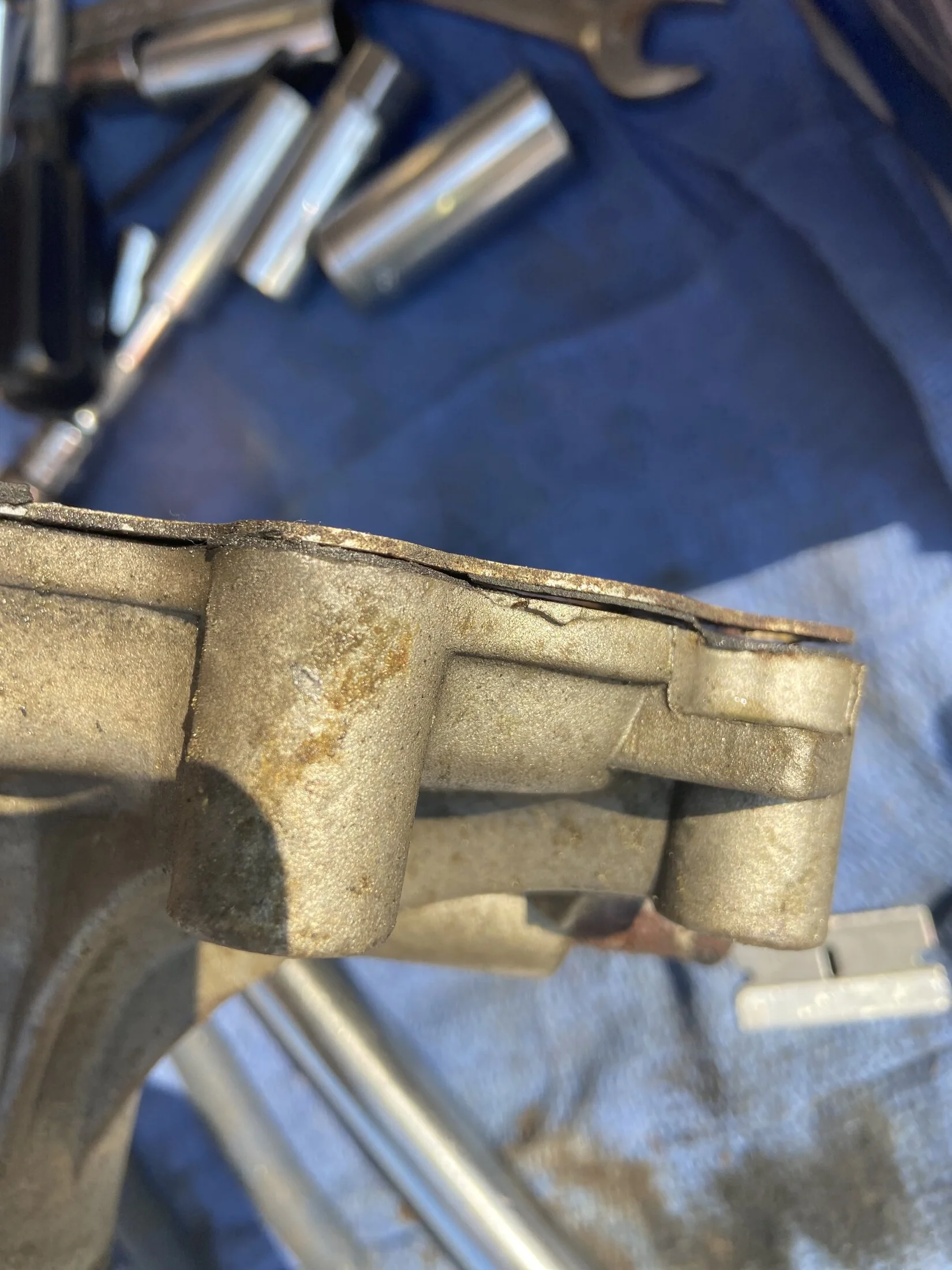

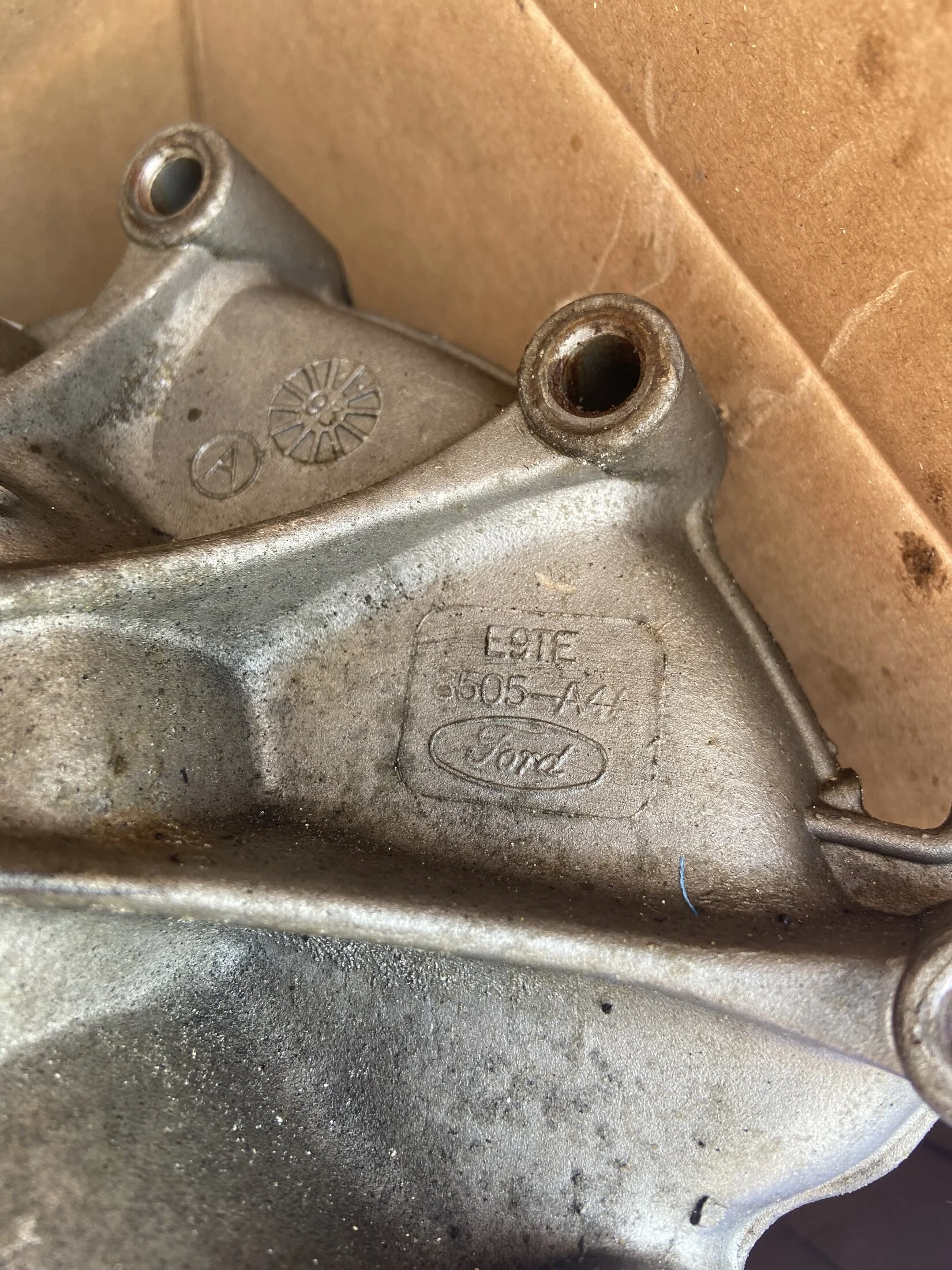

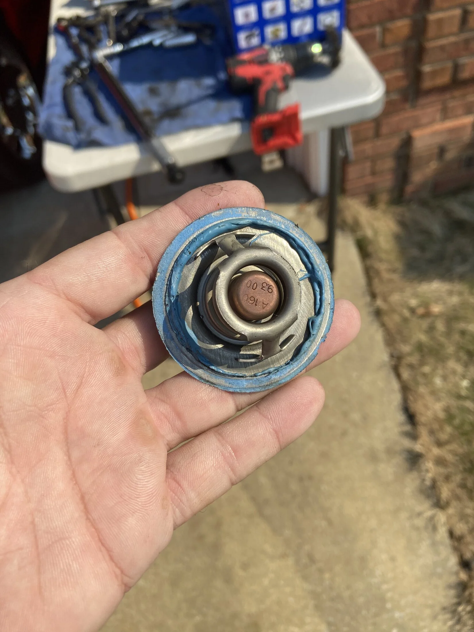

Apparently the water pump got jealous and started crying today. Looks like the seal between the back plate and housing gave out. Guess it can only last so long. It was the OE pump so can’t really be upset. The worm clamps(that’s what I call them) are stamped ford also never seen that before(or just never looked). Now if I could find the previous owner to slap the mess out of him for using a whole damn tube of blue RTV on the thermostat/housing ‍♂️
Sucks about that leak but I’m sure you’ll get it. And yes…… those clamps with the Ford logo are OEM stuff. Probably better than anything you can buy today.
