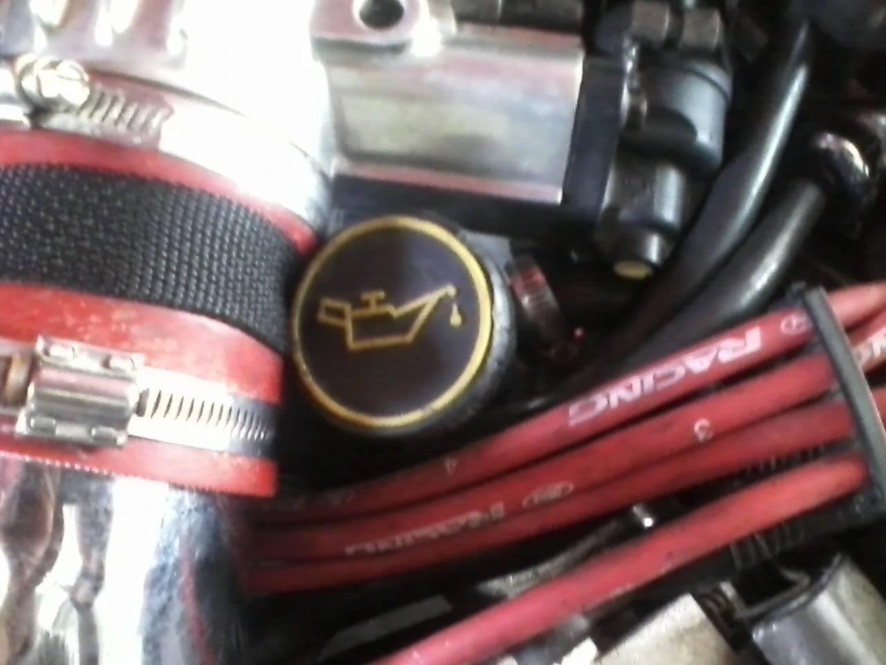

Also I have the 86-95 chrome valve covers and once inquired about an extension that someone sells and cant remember if it was this forum or where that someone knew of something that could be bought to solve the problem of the annoying trying to get the oil fill cap off because its resting against the cold air tube.
anyone know ?
