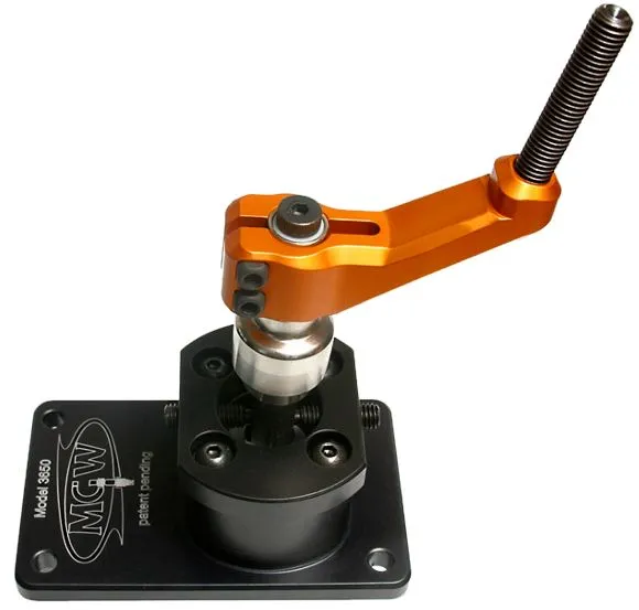

Henceforward The Avatar Master Founding Member Jul 17, 2001 485 0 0 Mar 9, 2006 #3 Mar 9, 2006 #3 If MGW makes one that fits the Saleen 5 speed, get MGW. Tremec 3650 Shifter $179.00 http://www.mgwltd.com/mustang_shifter.shtml Attachments mustang_shifter_3650.webp 16.1 KB · Views: 110

justin Founding Member Oct 7, 1998 416 0 0 Westville,IL Mar 9, 2006 #5 Mar 9, 2006 #5 I have a MGW on mine and I love it. The best shifter that I've ever had by far. You won't miss 3rd with this guaranteed!

marcus95 Active Member Jan 26, 2004 2,133 0 46 California Mar 9, 2006 #6 Mar 9, 2006 #6 Another vote for the MGW. It's the best shifter out there is far as I'm concerned for your trans.
S sy1172 New Member May 11, 2005 175 0 0 Mar 9, 2006 #7 Mar 9, 2006 #7 This one right? Tremec 3650 Shifter $179.00 (plus shipping and handling)
