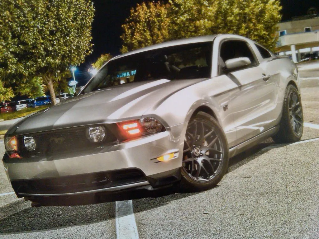

Steeda Sport springs and Koni Yellows work magic.
Sent from my MB855 using Tapatalk 2
