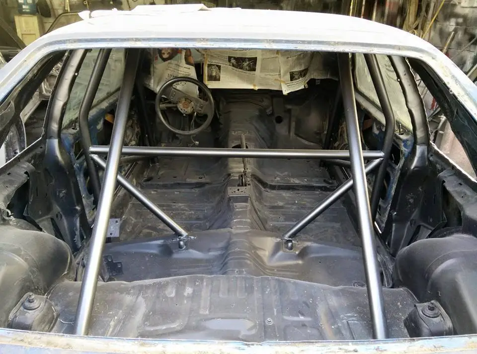

Current parts in transit are a Competition Engineering 8 point rollcage, Steeda subframe connectors, torque boxes, Prothane bushings, Prothane motor mounts, H&R springs, and Bilstein shock absorbers.

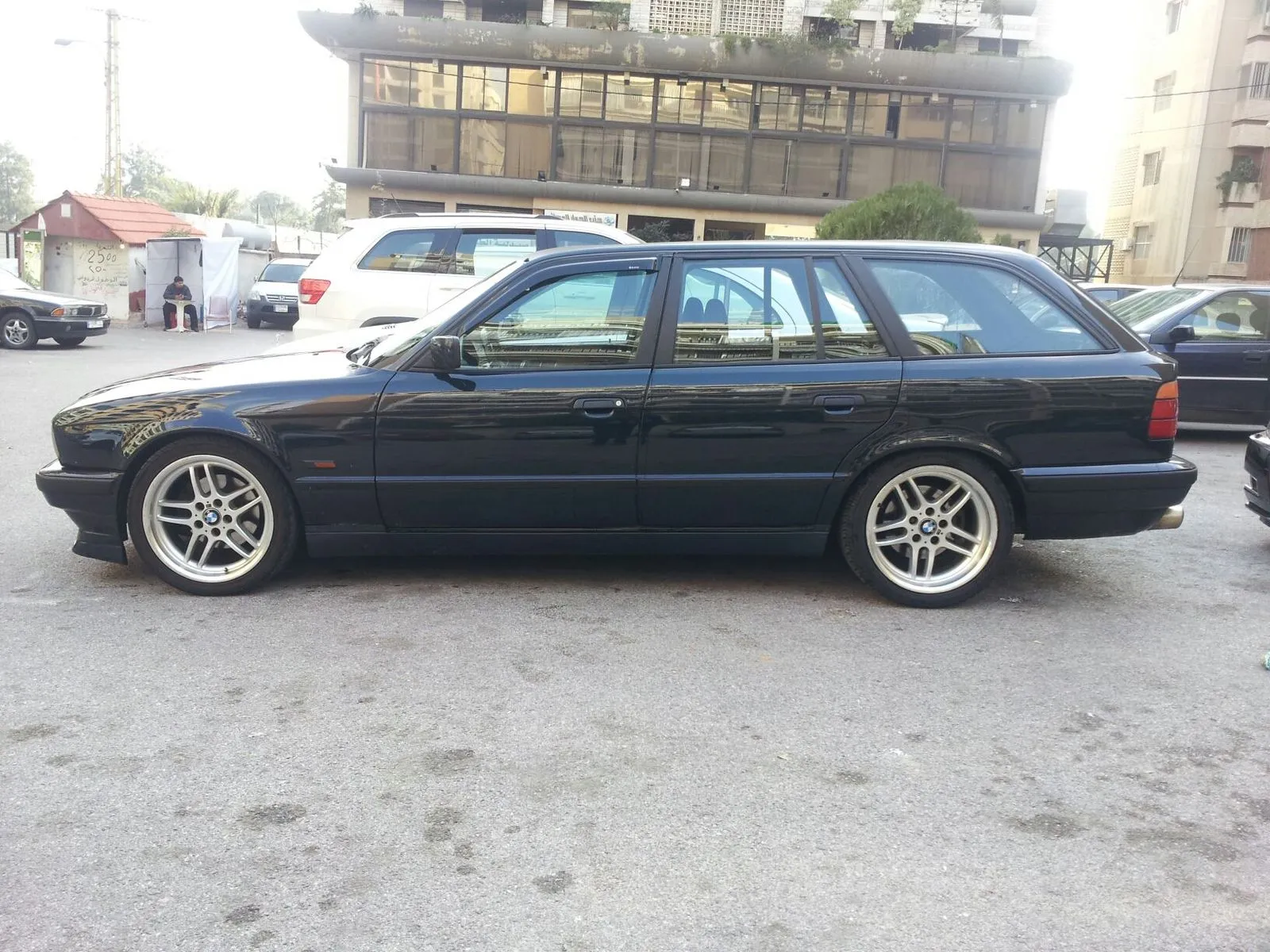

Here's one of my other cars, a 1996 540iT/6. One of 499 made! It's fully stripped, has plenty of suspension mods thrown into it, and a highly developed aggressive tune and some basic mods. Made 282whp/295wtq last time I had it at the dyno, before I adjusted the AFR's.

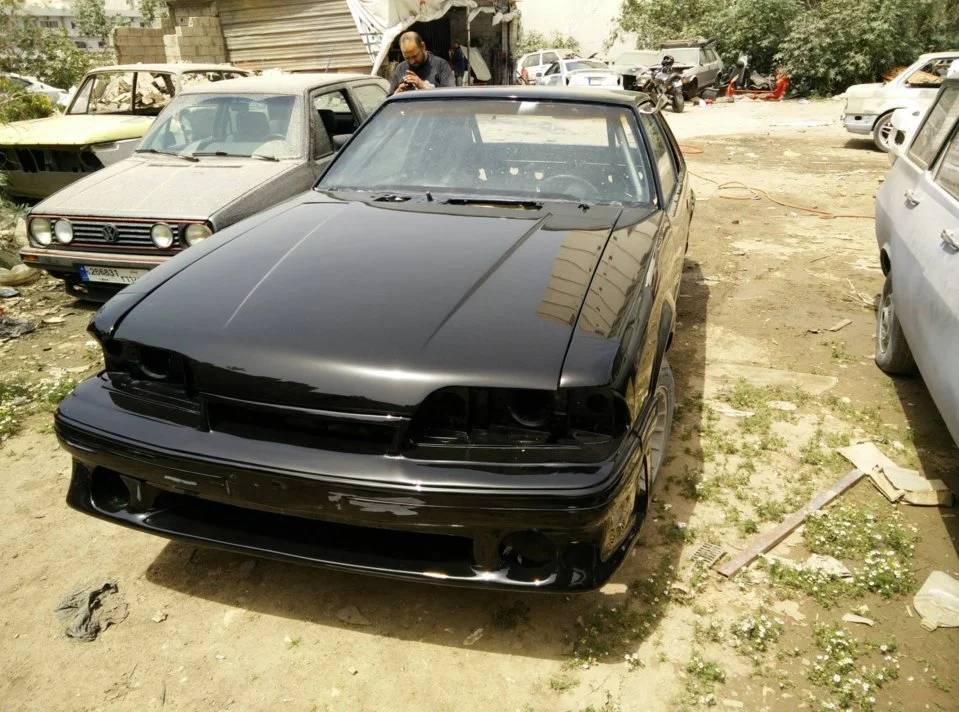

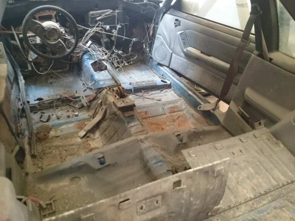

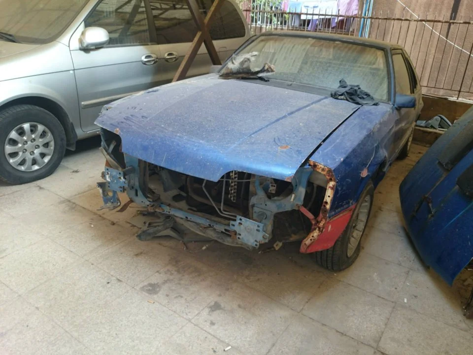

Here's Foxxy. Doesn't look like much now, but she's going in for a full bodywork restoration. She'll be done in a couple of months, body wise. I've already taken out most of the interior, removed the motor/tranny, and purchased glass replacements. Currently looking for a new front bumper and trying to decide what headlights I want. While I don't really like the OEM 3 piece lights, I can't find a single 1 piece light that doesn't look too Fast and Furious-y. I wish someone made an OEM looking unit, just 1 piece.
As I'll be tracking/drag racing the car eventually, I'm going to try to keep weight down. Keeping the dash and HVAC, but probably going to get a CF hood, plexi rear window, and rear seat/carpeting delete.
