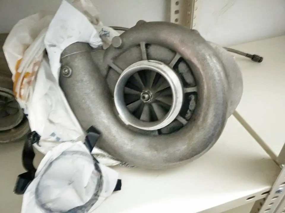

I'll put some part numbers for brackets and pullies together when I get into my shop later today. As far as the head unit you have goes, is it straight discharge or curved discharge? I also want to verify that it is standard rotation and not reverse. Do you have the serial number handy by chance?

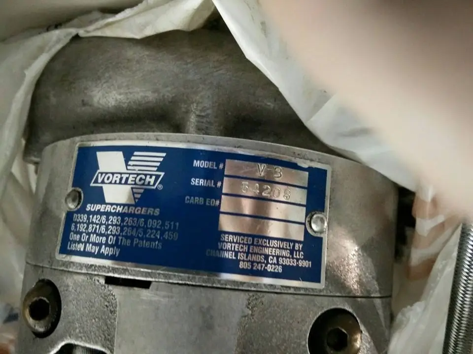

Indeed I do. As per the blue Vortech stamp on the head unit:
Model # V-3
Serial # 54206
The unit came off of a 2011 Camaro L99. Head unit has less than 5,000 miles on it. Owner decided to go for a V7. :)
