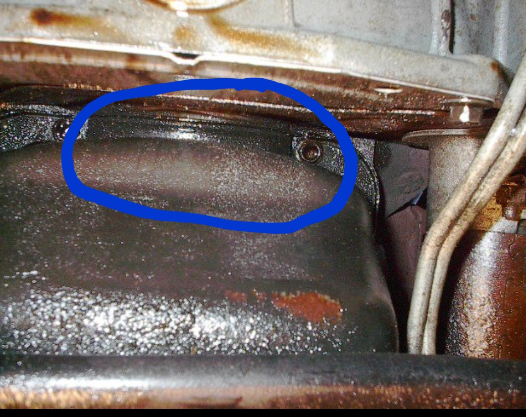

I'm still trying to track down if the rear main seal is leaking. There is definitely seepage from the front and sides of the oil pan but not a noticeable drip. But there is a drip when the car is not running which is coming from near the top of rear of the oil pan where it meets the transmission? Then it drips down the cover. Attached photo is one I found in another thread but I have the same kind of leak.
Can both the oil pan gasket and rear main seal be changed at the same time or they totally 2 different jobs. If my rear main seal is leaking, I was hoping to put that off until it's time to change out the clutch.

Its common for these engines to leak at the back of the pan. Because of the added severity of the seal repair I'd replace the oil pan gasket first. Also, check the rear of the lower intake where it meets the block....if it leaks back there it'll find its way down to that same area. That area back there is really hard to see...may need a mirror and a flashlight. A scope would be even better but expensive.
