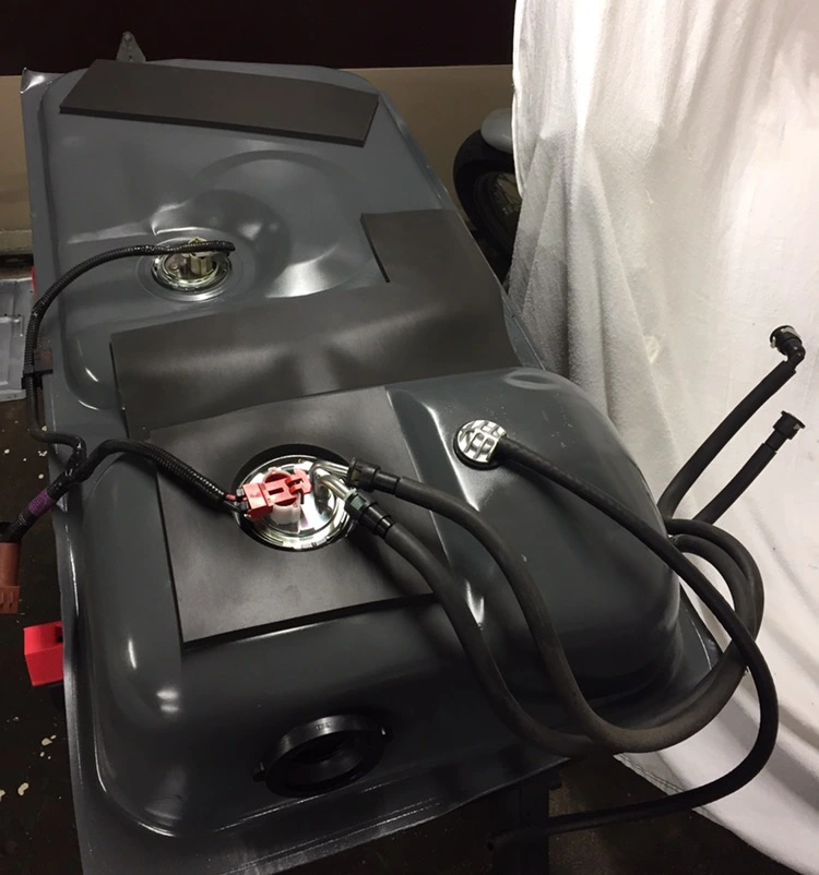

The original tank in my ‘88 was spotless inside, even after sitting for years with e10 inside. It was as clean as the day it was built.
If the baffle wasn’t busted inside, I would have kept it.
Replaced it with a spectra premium tank, and my usual touch
Reactions: 90sickfox, Mstng93SSP and General karthief
That painted vent sure looks nice.

He stole that idea from me. We were having a who’s new gas tank is prettier competition, but he killed me with his new rubber lines and preformed tank pads. I cheaped out and used foam tape. But yes, he has taken every part of his car he has retouched to an extreme level of perfection.
