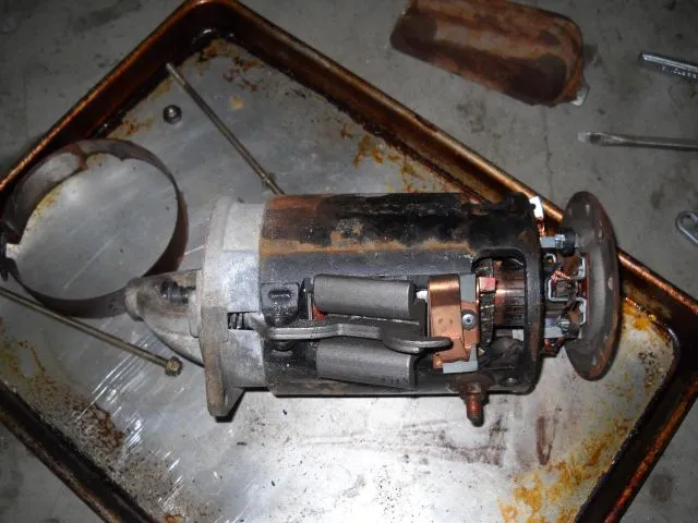

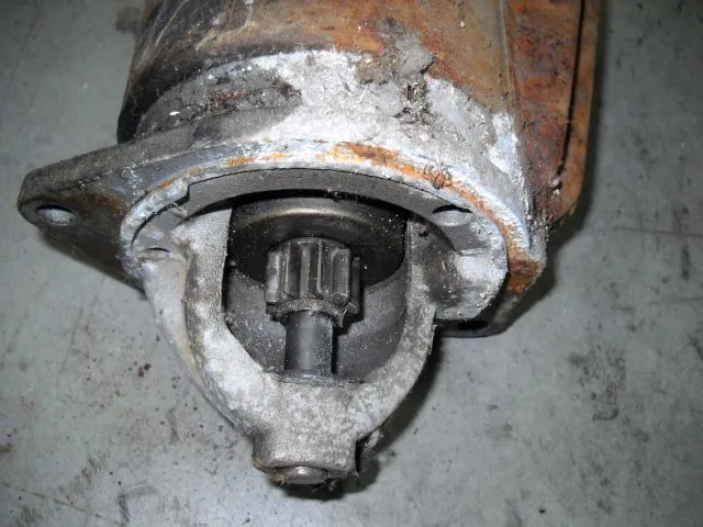

in case something was binding, i decided to take the starter off the engine, then I had the bright idea of using a battery charger set to "Engine Start" to try and get it to spin, that did not work
since i couldn't spin the gear by hand both ways, I decided to take the starter apart inspect the brushes and clean it up a bit with electronic parts cleaner, battery cleaner for the corosion, and trusty WD40, after I cleaned it I could now spin it by hand
I tried the battery charger trick again and it still did not work, so I started my truck and hooked up jumper cables to it and hooked up the negative to the core, and tapped the positive on the side bolt, this made a few small sparks and still did not spin the starter
remember I am doing this to learn first, to do it right the first time is option two, plus I don't have much money to spend on this
tomorrow morning I will take it in to AutoZone and have them bench test it for me, I may pick up a brush kit for $15 bucks to learn how to rebuild a starter, I know what used brushes look like now, so if the new ones look in much better condition I will buy them
I'm learning and I'm having fun, got any ideas for me?

The drive will spin somewhat freely in one direction, that is the overrun clutches working. It should be harder to spin in the direction it locks up so it can spin the engine. The commutator looked fairly good from the picture. I could not see the brushes. The starter draws about 45 amps during dree spin and around 125 during cranking. Good Luck.

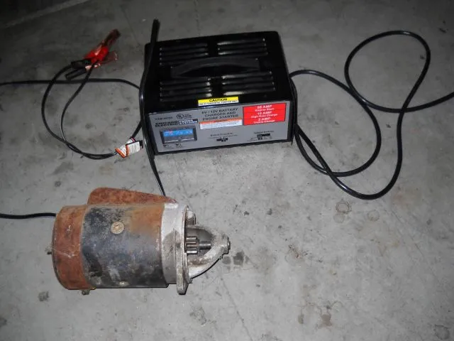

I tried putting my battery charger on the battery set on AUTO START (as in boost the amps to start the car) and from there I ran the jumper cables to the starter and still the starter barely spun.
This is driving me crazy my dad and I used to test starters on the garage floor or in the appartment parking lot with our foot on them and they went zooom way fast, what the heck is up with this one.

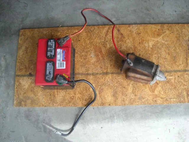

IT WORKS
So I went to a junk yard where I bought some battery cables among other things. I cleaned the heck out of the cables and bolted them on to the battery terminals and bolted the positive cable to the bolt on the starter. Then I tapped the neggative cable to the starter housing and whalla it spins like mad and the bendix jumps forward. I owe a beer to the guys who kept saying you must have a good connection and the battery cables may not be enough. Guys thank you very much for all your help this will be the last of this post I promise. Feels good to learn something and have it work.
See the picture of the Poor Man's Starter Bench Test Setup:
This
is not much of a power source. Thats not much bigger than my trickle charger.
And consumer jumper cables really aren't much for carrying high current.
