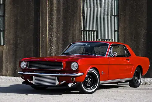

Heres my first car and reason for my Mustang obsession. Turbocharged inline six

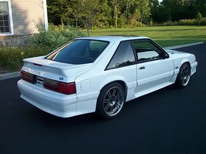

Heres my 90 Coupe before the 2nd 302 failed. She's under the knife as we speak.

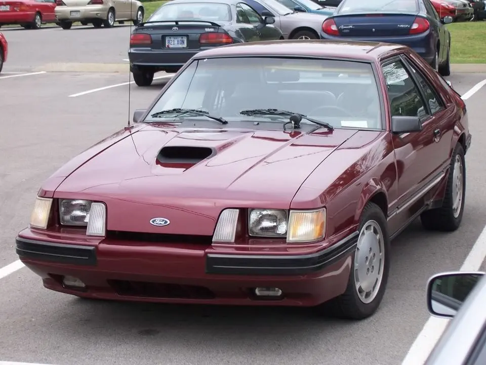

And heres the one that got away lol, 84 SVO. Loved the car, but it had to go :(

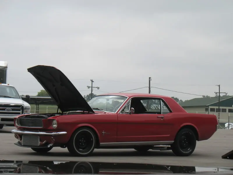

Love that '66. More info on the engine?
Original 200 inline six
.060 Forged Pistons
Custom grind 274 cam for boost
"Big Log" 70's head with valve job
Direct mounted Quickfuel 2 barrel carb
Buick BG turbo
Blow thru with front mount inercooler
World Class T5
Thats the gist of it, I run a dual boost valve set to 10psi and 17psi, but if I dont turn the timing down on 17psi on a cool evening itll pop the head gasket lol. Been thru about 10 Felpro head gaskets, but if the tune is right itll hold pretty well!!! Put down 280rwhp/320rwtq on 17psi on a really bad tune.
