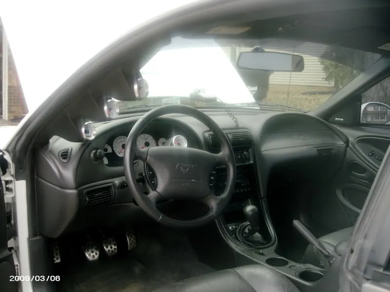

passport hardwire kit tap into power at the trac off switch near shifter, remote mute button mounted in useless coin tray, wire runs up into center console then above pedal area under steering wheel, then under weatherstrip at door up to the point it enters the A pillar, runs inside the headliner and pops out just enough above the mirror to reach the detector
I use a similar setup as tag4car. I've got a V1. I tapped into the power wire for my sunroof by the fuse box near the pedals and fuse box. It runs up the weatherstrip and headliner then sticks out just enough to plug into the detector right above the mirror. This works well, I've gotten pulled over (so called careless driving, no radar was used) and the cop never noticed it there.

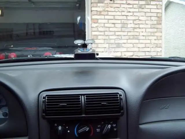

I just ran my cord across the pas. side windshield between the windshield and dash then opened the glove box and ran it behind the glove box then down to the cig. lighter. Easy and simple if it makes sense
Hard wired to radio ign, so shuts on and off with the car. Never have to touch it.
i would mount mine up like that but i have the dot matrix with the running pony up there... not sure how well it would stick
About the trac off switch, If you want to use this method, tap the pink wire for positive power. it's a key on ignition on switch so it runs only during "run"
Don't have a pic, but mine is velcro'd to the dash and the cord runs into the defroster vent, behind the center stack, and taps into the dead plug where my traction control would be if I had it ( I have a no-options 04 but it still has all the wiring). Looks very clean.
