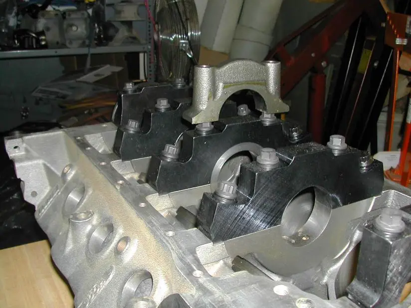

Well my choice was a dart sportsman simply for the good deal I got at BBR. Compare the two, stock block and dart block WOW the thing looks like something they put in a tank. Check out the pic. That's a stock two bolt main cap on top. Mike
