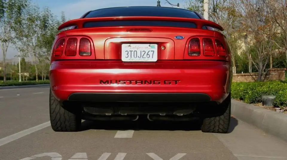

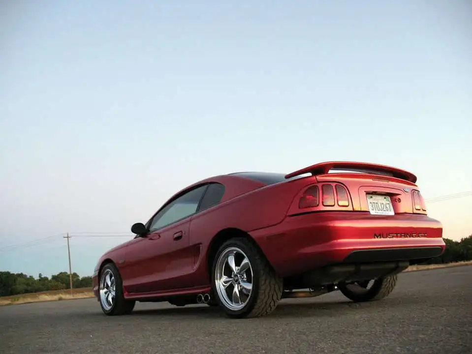

imo side skirt just double the cost cuz you have to pay a good amount for them then a good amount to paint match. But if you do build the side pipes, dont use a snake back muffler, just use the shortest cylindrical muffler you can find (i used magnaflow magnapack barrel mufflers) they need to be thin so they can be parallel.

Damn i love side exhaust! I'm just not willing to give up the few hp you lose...Looks good cobrared!
You only lose power on the snake back design that spintech and roush use in there "same-side" muffler deign and needless long pipes. If you see i go right from midpipe to the barrel muffler then a gradual bend out to the side. Not only does this not lose power, i'm willing to bet it's more effcient than going over the axle and back down out the back. This is why i fabricated it this way, couldn't stomach paying twice as much for a performance inhibiting design - if i remember right i was around $350-380.

ha, she says thanks. It has that 03/04 cobra exhaust look form the back being able to see the pipes come horizontally - me like. I definitely know what your talking about having it look just right to not look like shyt - i think it's harder on sn-95's w/ SVO skirts than for 99+'s w/ roush skirts.
