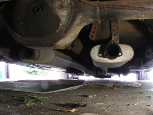

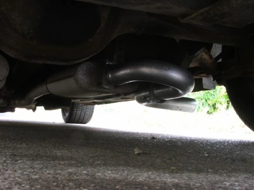

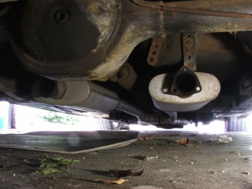

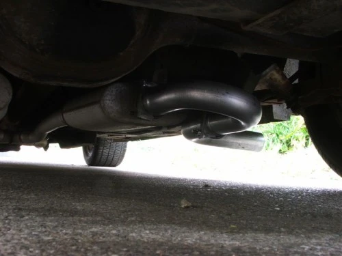

If you're getting fumes with tailpipes something else is up. Leaking trunk seal, exhaust leak up front, grossly rich mixture, etc.. Trust me, turndowns will make the fumes much, much worse. I did sides on mine after having turndowns and the fumes are a little better, but it's louder to the ears when the window's open under acceleration.

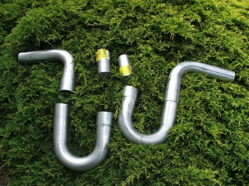

Dynomax "side pipe extension kit" ($50) plus a couple of clamps, and I have 2.5" side-exhaust Magnaflows.
I don't have tips yet so it's still behind the rocker panels. I'm guessing once the tips go further out my fume problem will get better.
Can't comment on the after-the-rear-wheel side exit, except that I only see it on trucks.

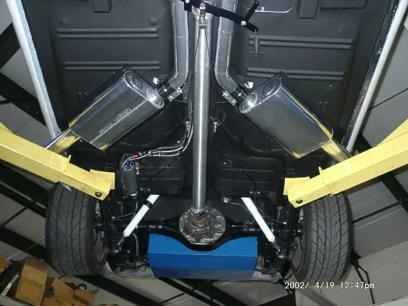

I'm looking for some ideas/pictures of side exhuast systems or anything besides the normal straight back duals. I thought about turn-downs, but I don't know if that would be too noisy; so the only other option I can think of is side exhuast, but I would want it to exit after the rear tire, not before (a.k.a. not like eleanor).
