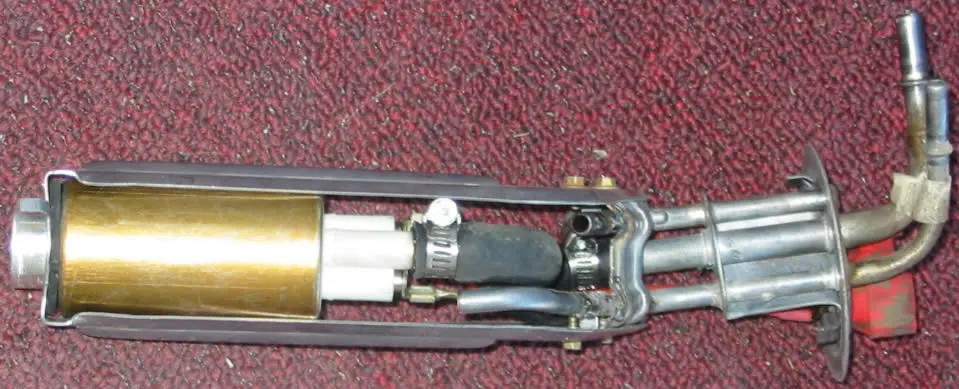

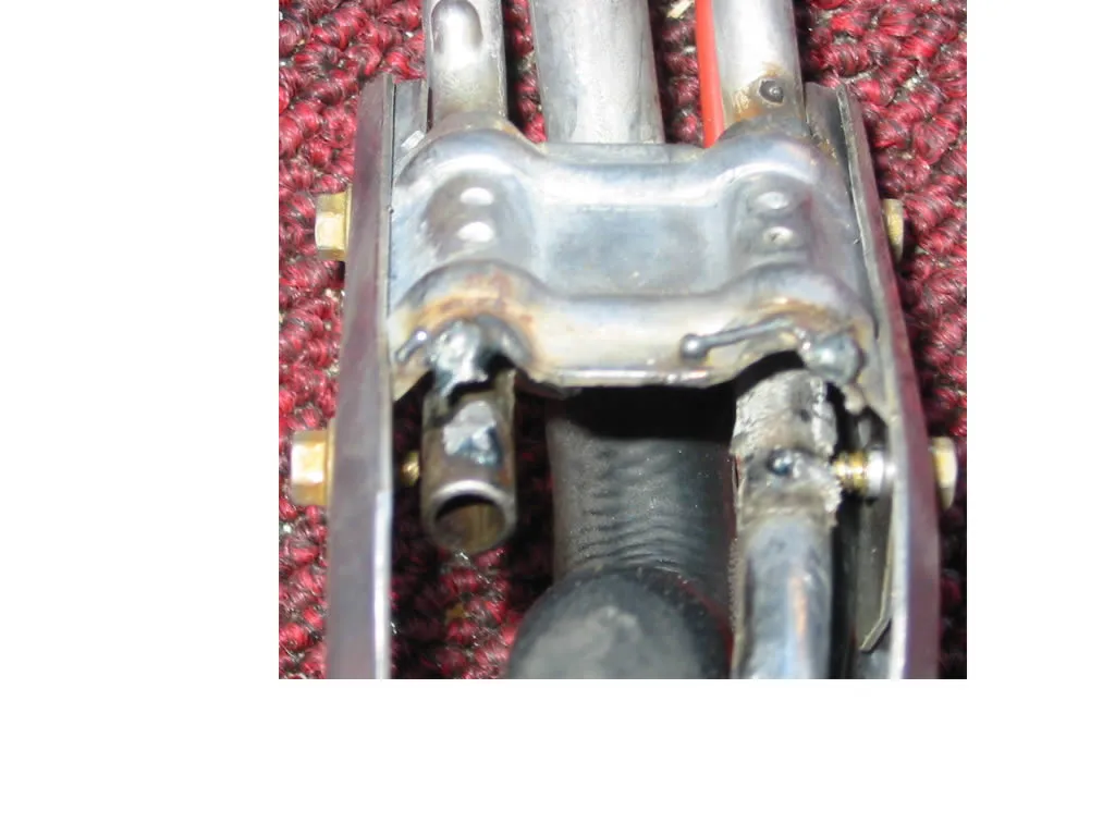

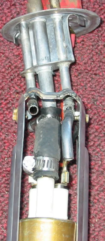

ok, i know you are all curious as to what has been happening..
with my poor 90.....
well, i will let you tell me if there is something wrong in these pictures....
now , this has all to do with the mechanic not putting the seal in right on the fuel pick up.... then i had problems with fluctuating fuel pressures...
wait...
there is more...

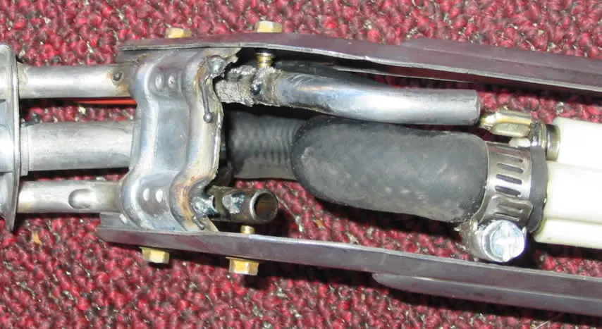

and if you guess whats wrong.... you get a prize.....
the rest of what is wrong with the fuel tank that the mechanic fracked up..
oh, i am not taking it back to them, i am taking them to the BBB , and possibly to small claims if i have to..... i will give them a chance to buy me new parts and get the tank baffel welded again, but i am doing it all myself..... if they cant do it right once, what makes you think they can do it right again....
screw that and screw them..... THERE IS NOT ONE MECHANIC IN VEGAS, THEY ARE ALL HACKS..
maybe it got bent when the installer didn't put the pump sock on correctly to line up with the factory baffle. he tried to push the assembly into the tank, wouldn't go all the way to sit flush on the tank, so he just muscled it into place.
i dunno what color pumps are these days, but the ones ive seen are silver in color or natural metal color. not gold like the one in the pic. also they normally have walbro on them, and a big W stamped on it. i also remember number were on it, one would be like GSS240 or something. the number would translate into what pump it was like 255, or 255 high pressure, or 190, ect....
sigh...
well, here is what happened, when putting in the new Walbro pump... they broke it, so they got a stock Carter pump and put that in there..... without telling me....
the owner was ver apolagetic and is refunding me my labor and buying me a new Walbro pump.....
the pick up i already have and i am having the tank baffle welded at a radiator shop.....
so , the car is down for at least another week....
