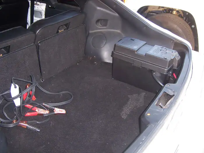

dude you you dont need to drop the tank to installed the battery relocation. Put it somewhere else, heres where i put mine. And I agree, just do your normal driving around and when the tank has 1/8 or 1/4 left then drop it dont worry about all that crap.

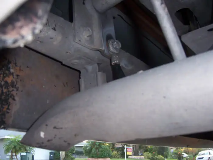

This is where I grounded it, im gonna change it but its worked for a few months now.
