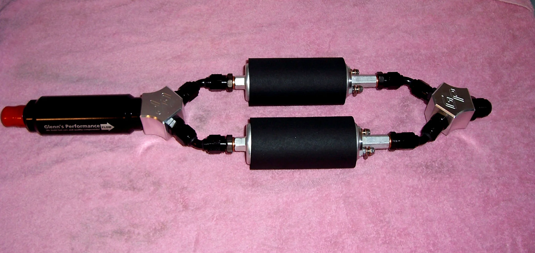

the 2 fuel pumps are inline and are located on the outside of the fuel tank.
The fuel line comes out of the gas tank (AN-8) into a pre filter and then into a Y conector to feed the 2 pumps
then another Y connector coming out of the pumps bring it into one fuel line, to a after filter and then to the
blow thru carb.

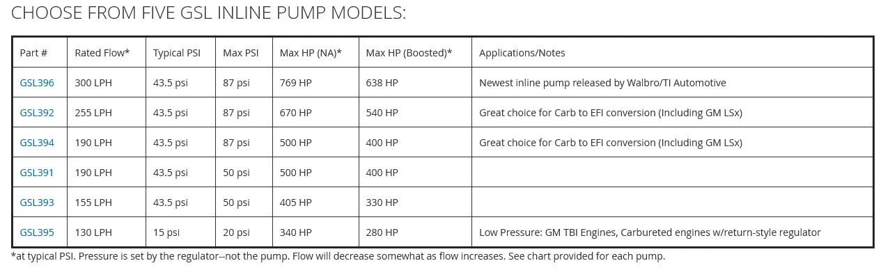

I want to get Walbro pumps the GSL393 pump looks like the one I need for my application, or so I think
that is why I am here asking. Thank you in advance for your advice, James.
Below are the specifications of the pumps,
Went into the other room but I'm here...so my first question is can you post up a picture of the existing pumps? In my head this just doesn't make any sense as typically you do not use pumps that put up EFI pressures to run a carb setup. Would also like to see a pictures of the regulator as the A 100 part number is not pulling up. Also, is the tank sumped or are you feeding it from a pickup assembly where the old fuel pump hanger mounted?

Please see below my fuel pump set up.

Okay, now I understand what you have going on. Two more questions, what is your maximum boost pressure and is the 586 hp on a motor dyno or chassis dyno? I read you have a 12 psi pulley on the blower but wanted to see if it was actually making that much or more.
Reactions: jimzzilla
I do not know what the maximum boost pressure is but the HP numbers were on a chassis Dyno.
Personally I think the 12 psi pulley is a little much but I do not have any extra room for a 10 psi pulley
due to hood clearance.
Okay, so you are well past 600 crank hp which means you need to step up to the GSL391's which can support 400 hp each in a boosted application so a total of 800hp. The GSL393's are 330 hp each so a total of 660 hp which gives you about zero room being the motor is probably making that or more on an engine dyno. Just my .02.
Okay, so you are well past 600 crank hp which means you need to step up to the GSL391's which can support 400 hp each in a boosted application so a total of 800hp. The GSL391's are 330 hp each so a total of 660 hp which gives you about zero room being the motor is probably making that or more on an engine dyno. Just my .02.
I think you mean the GSL393's...
