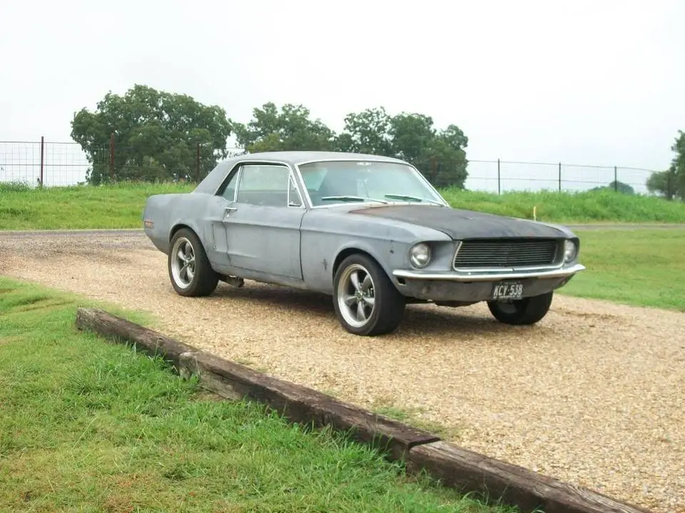

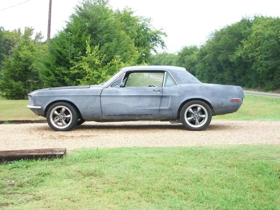

I'm not sure of the backspacing, but I used the factory Bullitts off my 04 GT on my 68 Coupe. The tires are 245/45 all the way around, though it really needs 225 or 235 in the front, it has very minor rub over big bumps and dips.
I used a 1 inch spacer for the fronts and a 1.5 inch in the back, though a 1 or 1 1/4 would fit a little better in the back, but these are ok for my car and I had them laying around. I have Granada spindles though, if that would make any difference.
This might give you an idea of my fitment with that setup.
